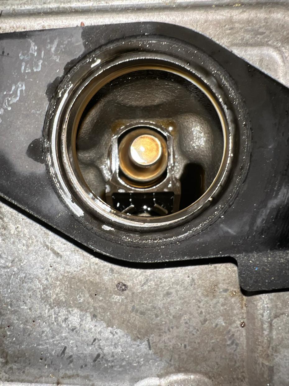

Well, after much diagnosis and throwing a few parts at it, I decided to pull the high pressure pump and take a look see. Well, has anyone came across this before?
It looks like the camshaft follower is loose? I haven’t pulled the valley cover yet but it looks funky.
Any updates on this? I'm running into a similar issue myself. Haven't pulled the HPFP off yet to look, but I'd bet mine failed. Had HP Tuners hooked up and fuel rail pressure reading was only 80PSI. Low side pump pressures were good. I did just recently do a cam swap and lashed the cam follower tip to offset the change in fuel lobe, so that could be an issue, too.
