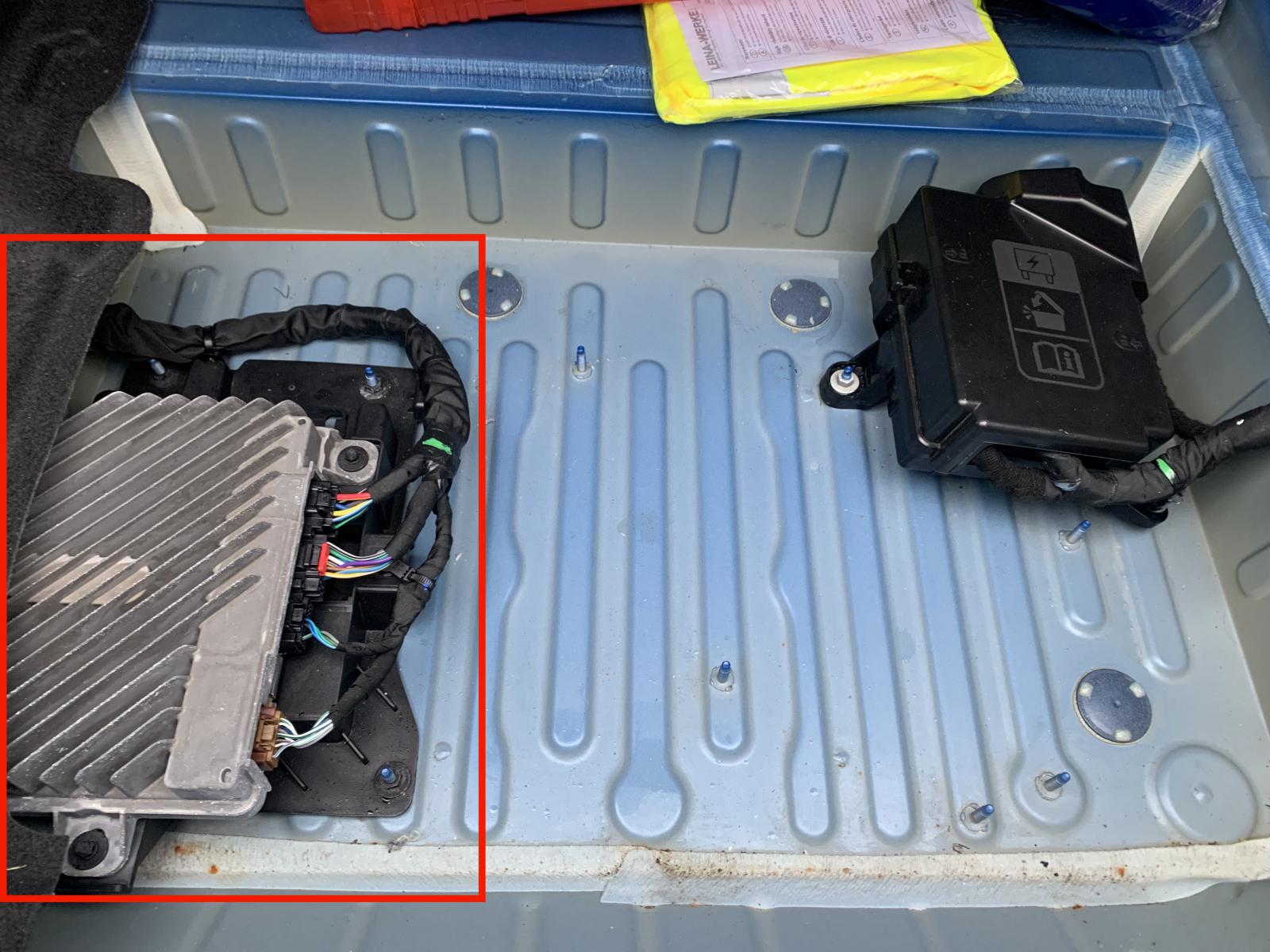

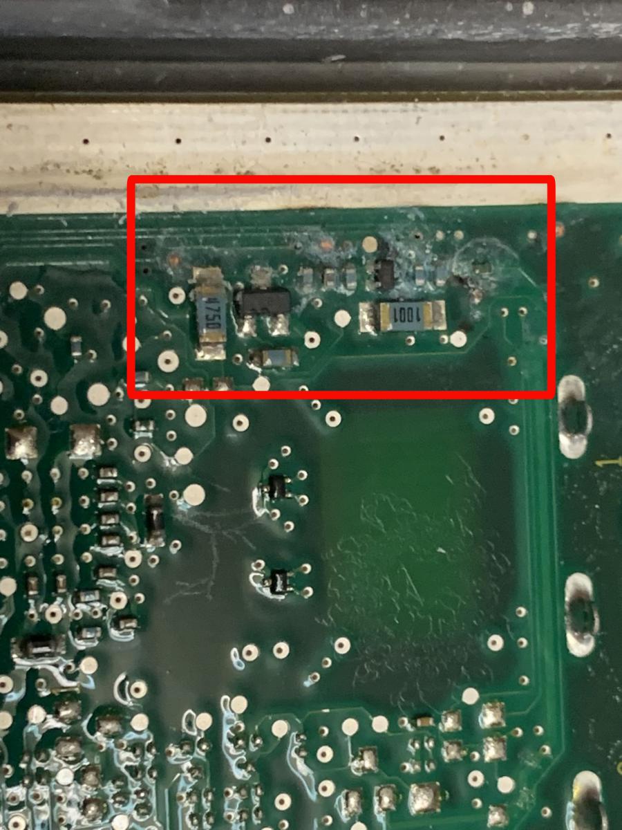

Hello,
I connected the fuse box, everything works, except the radio, I have no sound for the turn signals, the radio does not turn on, but if I put the reverse gear I have the image of the reversing camera.
The Bose amplifier is also in the trunk it is much higher than the fuse box, I removed it, opened it, there was only a little verdigris on one corner of the circuit board, I cleaned and reassembled.
Do you think it could be the amp if the radio isn't working?

Old 01-23-2023, 06:47 AM   #13
ctrlz
Location: Ocean City, NJ
Posts: 3,584
Glad it mostly works.
Probably amplifier damage as you suspect.
I'll have to look at your pictures again. But my recent experience with water-damaged electronics (Hurricane Ian) suggests there can be more damage than you first think.
EDIT: Can't seem to find if you posted pictures of the amp. Here's a thread with a story similar to yours. Hopefully you can replace this amp without dealer software:
https://www.camaro6.com/forums/showthread.php?t=570579

Old 01-23-2023, 12:57 PM   #14
lynyrd
lynyrd's Avatar
Drives: Camaro 2.0 LT 2018
Join Date: Nov 2021
Location: Belgium
Posts: 310
Send a message via Skype™ to lynyrd
Here's a picture of the corroded area of the amp's circuit board, is it possible that just that could short out the amp?
