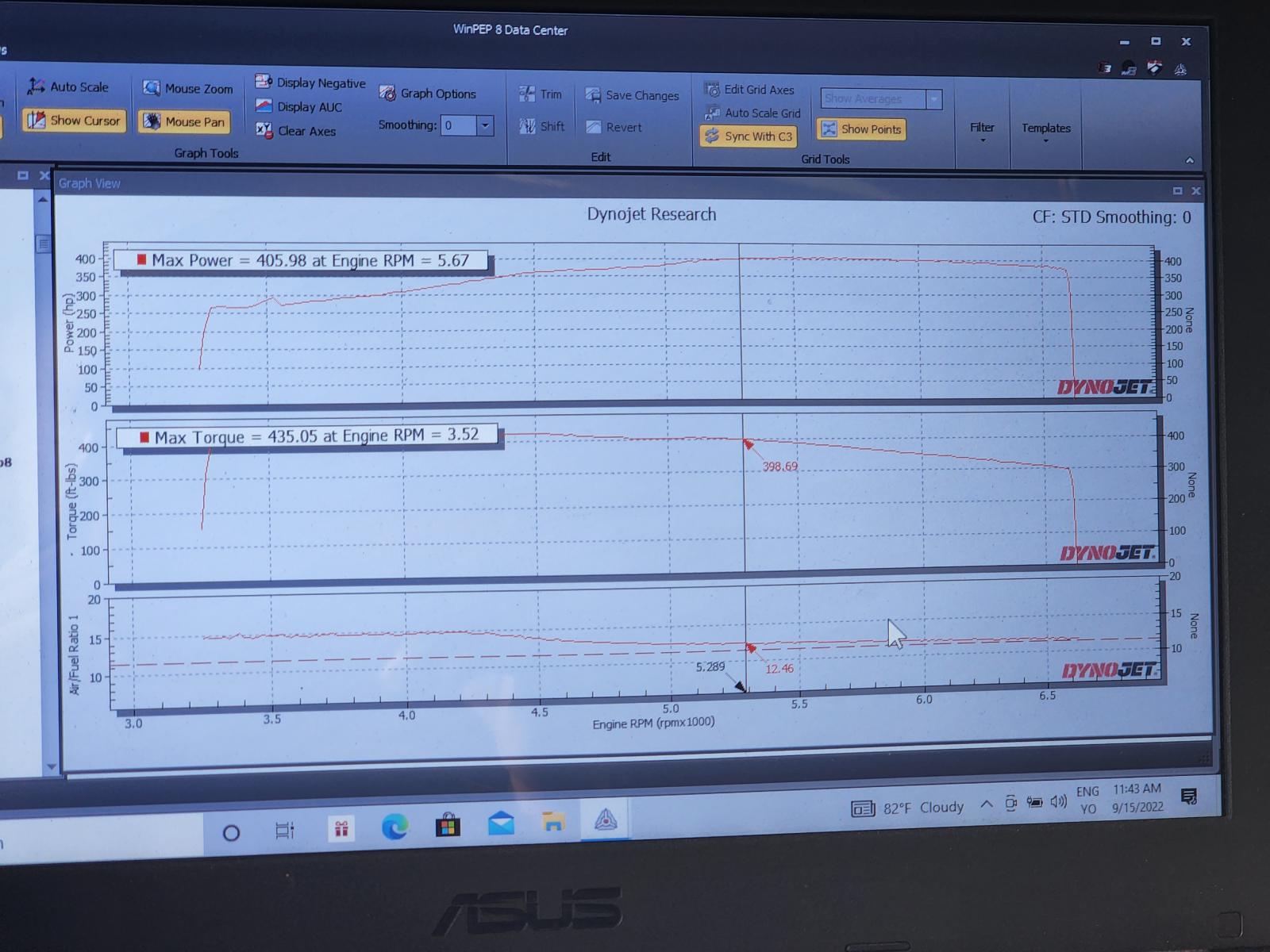

Hey guys I recently brought a P1SC procharger for my A8 2SS.
MODS: Speed Engineering 1 7/8 Headers
DSX FF kit
Full 3" from headers (cats removed) to stock NPP Muffler
Lt2 Intake Manifold
Rotofab CAI.
I dynoed 380 on pump gas and 405 with E50
I want to achieve 650whp
I already ordered:
Snow Performance Water/Meth stage 2 Kit
LT4 injectors,HPFP and low side
I am contemplating to pulley down from the start to 3.5 and that should put me around 11psi with my mods and elevation.
Any inputs are appreciated.
DSX FF kit
Lt2 Intake Manifold
Rotofab CAI.
Attachment 1117739
I already ordered:
