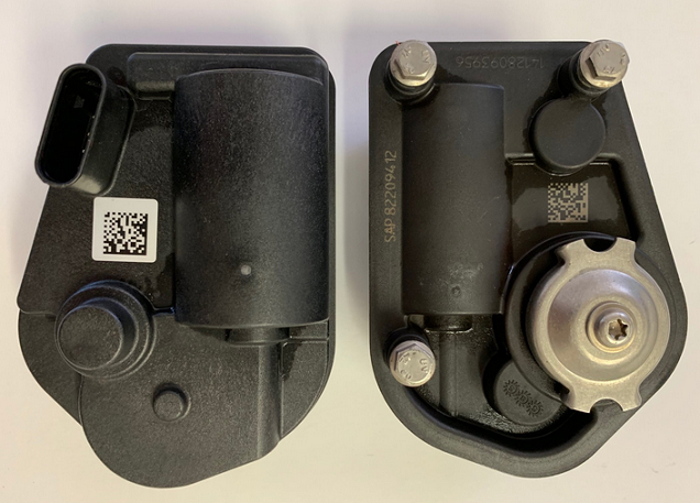

You only need to reuse the black actuator assembly with the "legs" that control the valves (see below), the physical rotating valves themselves will be removed along with the stock exhaust and your Borla setup should have counterparts.

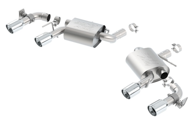

There should be a fitting for the valves as shown in this pic
My Borla ATAK has it and the factory motors just bolted right up

Looking further on Borlas site and it appears all the cat back systems do not have the piece for the valves while the axle backs do
For example my system is Part#11925 and it is like the pic above, you however have a 140688 and even on the Borla site no valve fittings.
Time to call Borla and ask them what's up
