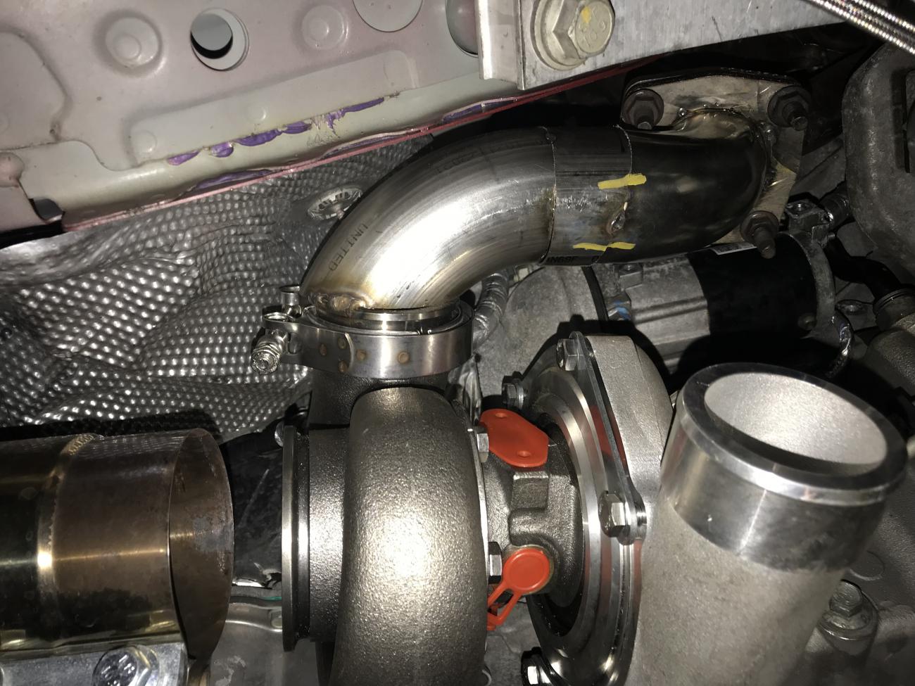

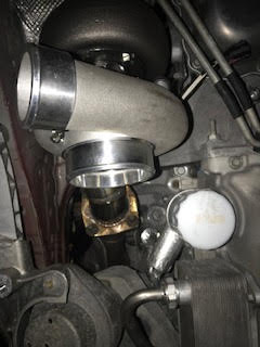

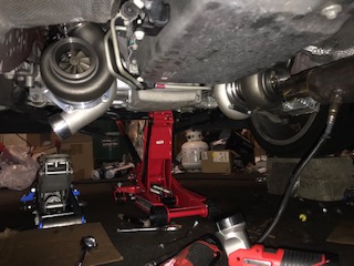

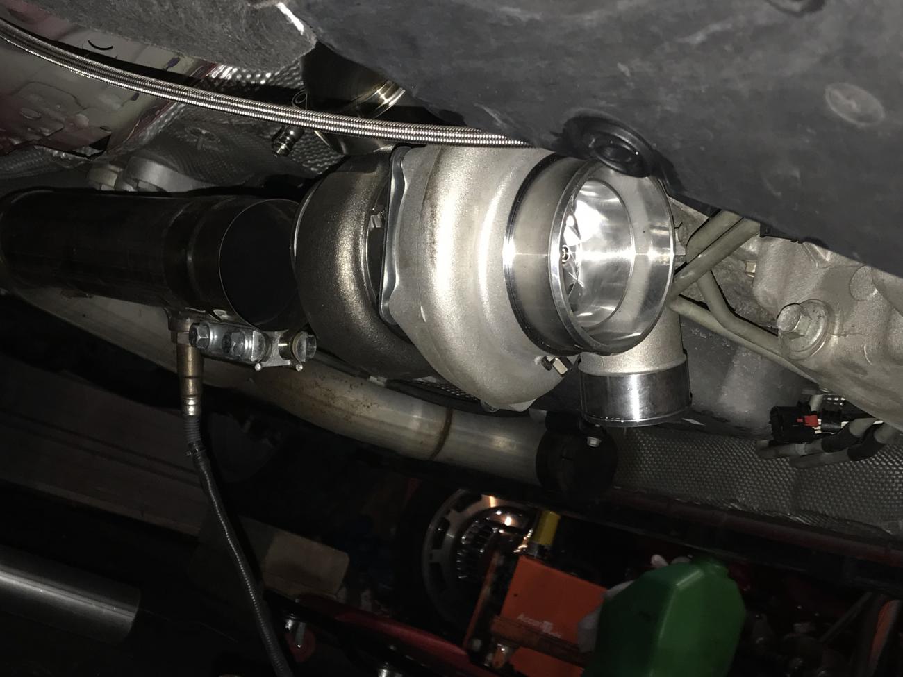

Little update I’ve been working on fitting the turbos, finally got the passenger side to fit in. The drivers side is looking to be a lot easier with more room for activities. I did end up going underneath using the stock manifolds. Pretty sure I could pull it off up top using them flipped over but fitting down pipes down to the car back was going to be a nightmare. Here are some pics. Oh and I’m not a professional welder, bought a tig and taught myself how to use it a few years ago.

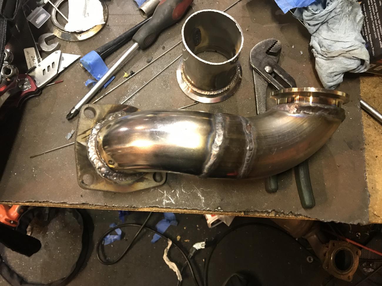

Got the second turbo hung. Wastegates should be here this week. The plan is to route them back into the after turbo down pipes then into the mbrp cat back. Once all the hotside stuff is done i'll be moving to oil feed/return and then cold side & intercooler.

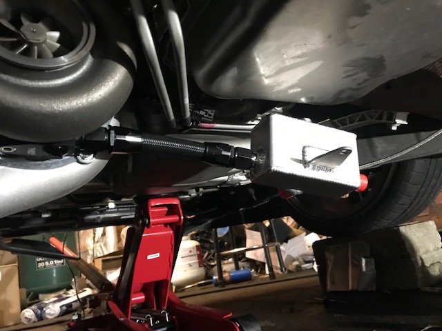

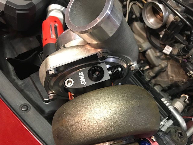

Just realized i didn't really take pictures of the wastegate additions but they are on. Got dedicated motorsports side exit turbo drains and their expansion tank. I contacted Hellion turbo and they sold me their oil temp sensor adapter to use as oil feed. That should be here this week. Ideally by the end of the weekend all oil parts will be done, feed, drain, pump return etc

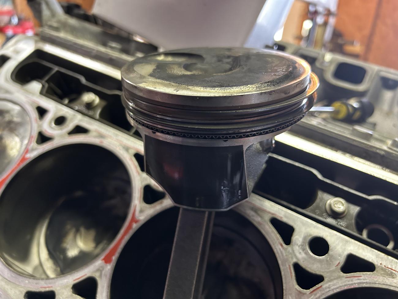

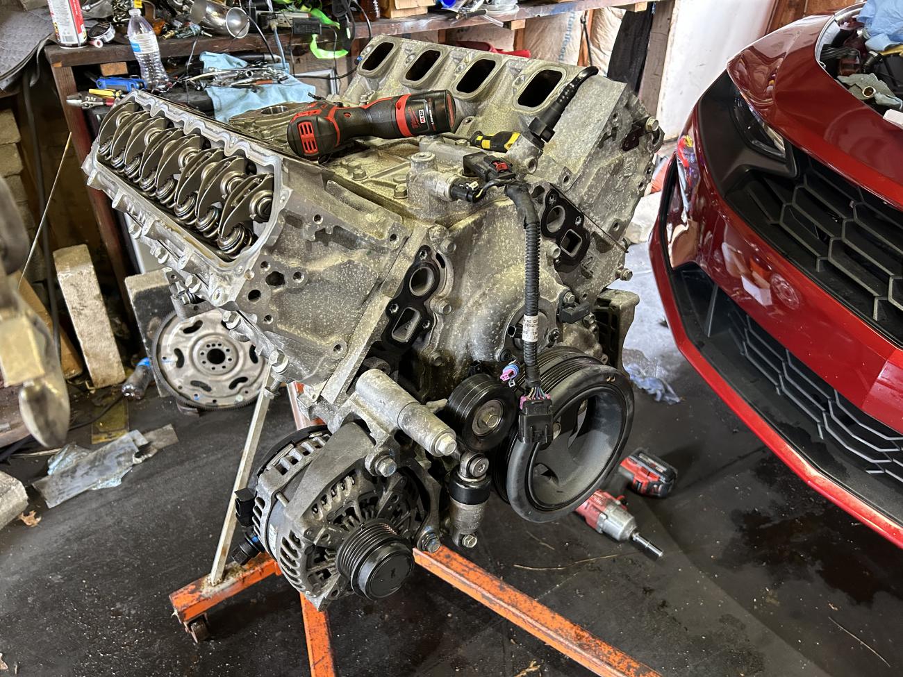

Don’t do what I did

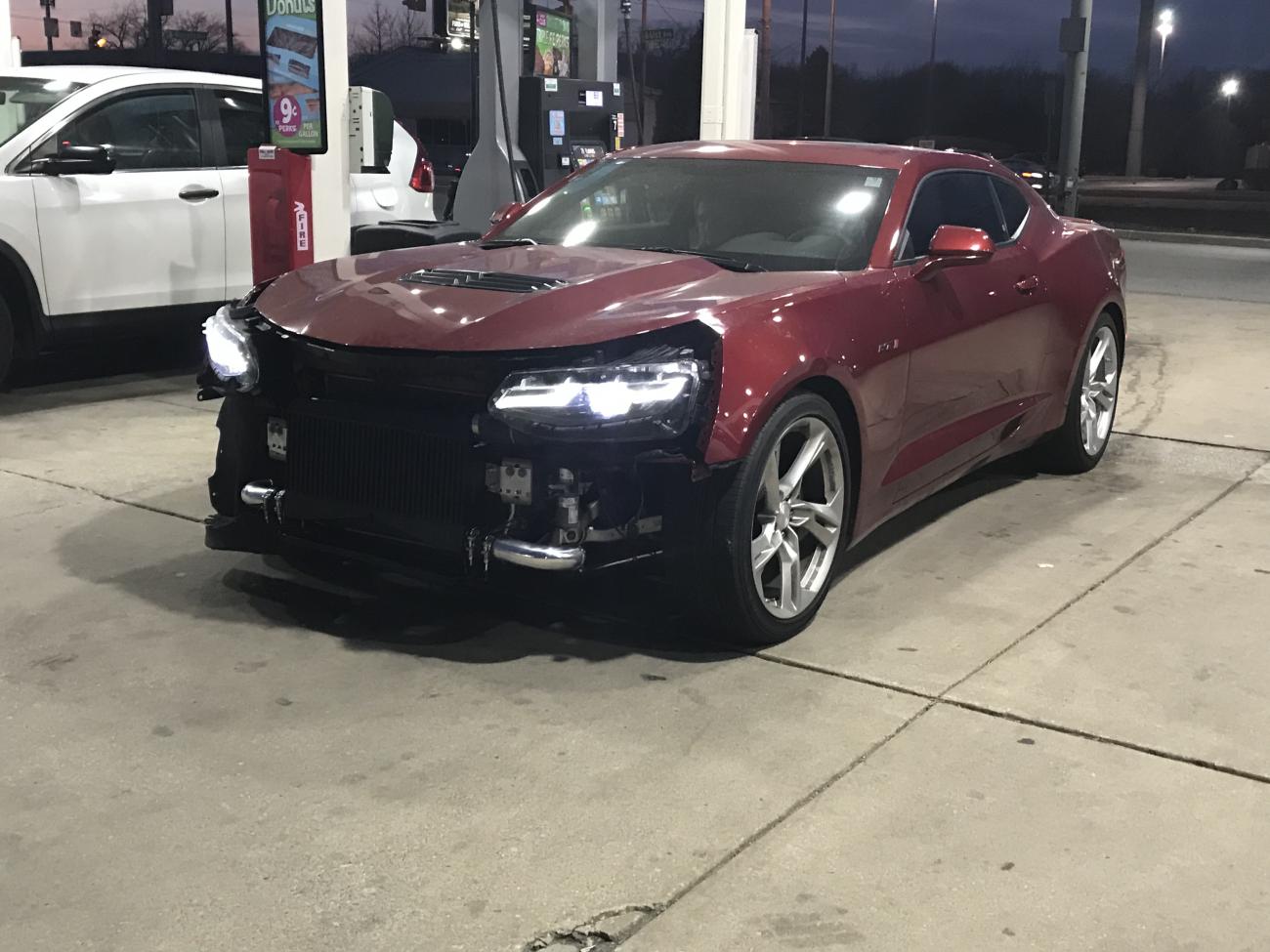

So I finished up the turbo build, got the car out and started dialing in the tune on low boost (2.5-3lbs). It’s definitely not easy but I was getting it sorted out. On the way to my test spot the car wasn’t idling great and that should’ve been an indicator but messing with virtual torque previous to this I thought I had just screwed up. Made two 1/8 mi hits and on the second hit the engine locked up and wouldn’t restart. Tore the engine down and I spun #7 so bad it actually cracked the journal on the crank and it is now junk. Looking back at everything and why it went wrong, I did have some kr through my tuning process but not on the 1/8 mi hits. What I believe is my issue is the turbo scavenge pump return. I ran it to the stock catch can return port on the oil pan. I thought I was being slick and had seen other people do it. Well the tube inside the pan goes all the way to the bottom and faces the oil pump pick up. Gravity draining to this port wouldn’t be bad in its current configuration but pressurized oil and air being pushed through it I believe i aerated the oil causing the bearing to spin. LT1/L86 cranks are unavailable for who knows how long. I ended up ordering an L8T crank from scoggin Dickey and a drop in je/tsp h beam combo from Texas speed to get me back going. Hopefully you guys won’t crucify me too bad but I’m sharing this to hopefully help some one attempting something similar in the future.

Pics for reference
