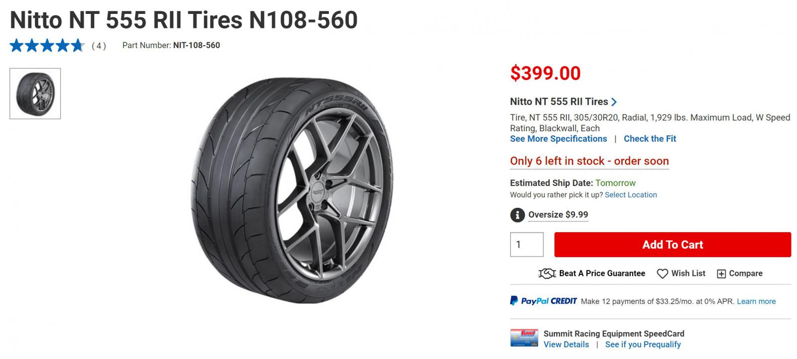

What tires you putting on the rear of the ZL1 stock wheels for traction??
Looking at these. thoughts?
My car is making just shy of 700rwhp. Looking for something to be better than the stock tires but not pretend to be drag radials. Something to play with in the corners, but straight line stability as well for just the street.

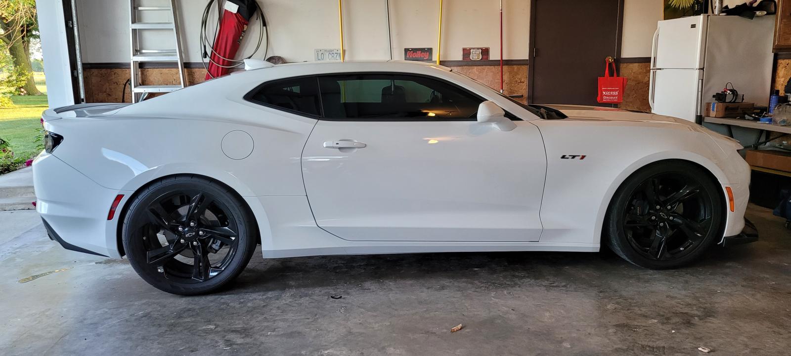

I would run the 305 35 20s instead of the 30 series. With the blower you can use the taller tire to control some of the wheel spin. King runs the 35 series as I do. The 30 series sidewall is just to short. I ran the 10.34@135 on this tire at the Ls Fest.Name:  20220902_190043.jpg

Old 11-14-2022, 08:51 AM   #10
JimGnitecki
Drives: Chevrolet Camaro LT1
Join Date: Sep 2022
Location: Alberta
Posts: 336
. .. Nitto says there is not a set of 555R2 in the US right now.
Yeah, my 2 Nitto 555R2s were the last 2 of 3 in Canada!
Jim G
JimGnitecki is offline   Reply With Quote
Old 11-14-2022, 08:54 AM   #11
KingLT1
KingLT1's Avatar
Drives: 2016 1SS NFG A8
Location: 46804
Posts: 7,665
Jim G
The listing in the OP shows 6 in Stock.
To clarify, Nitto told me there were no 335 or 345 in the US. Summit's site says the NT 555 RII, P345/30R19 has to be special ordered with two week delivery. I'll call them.
