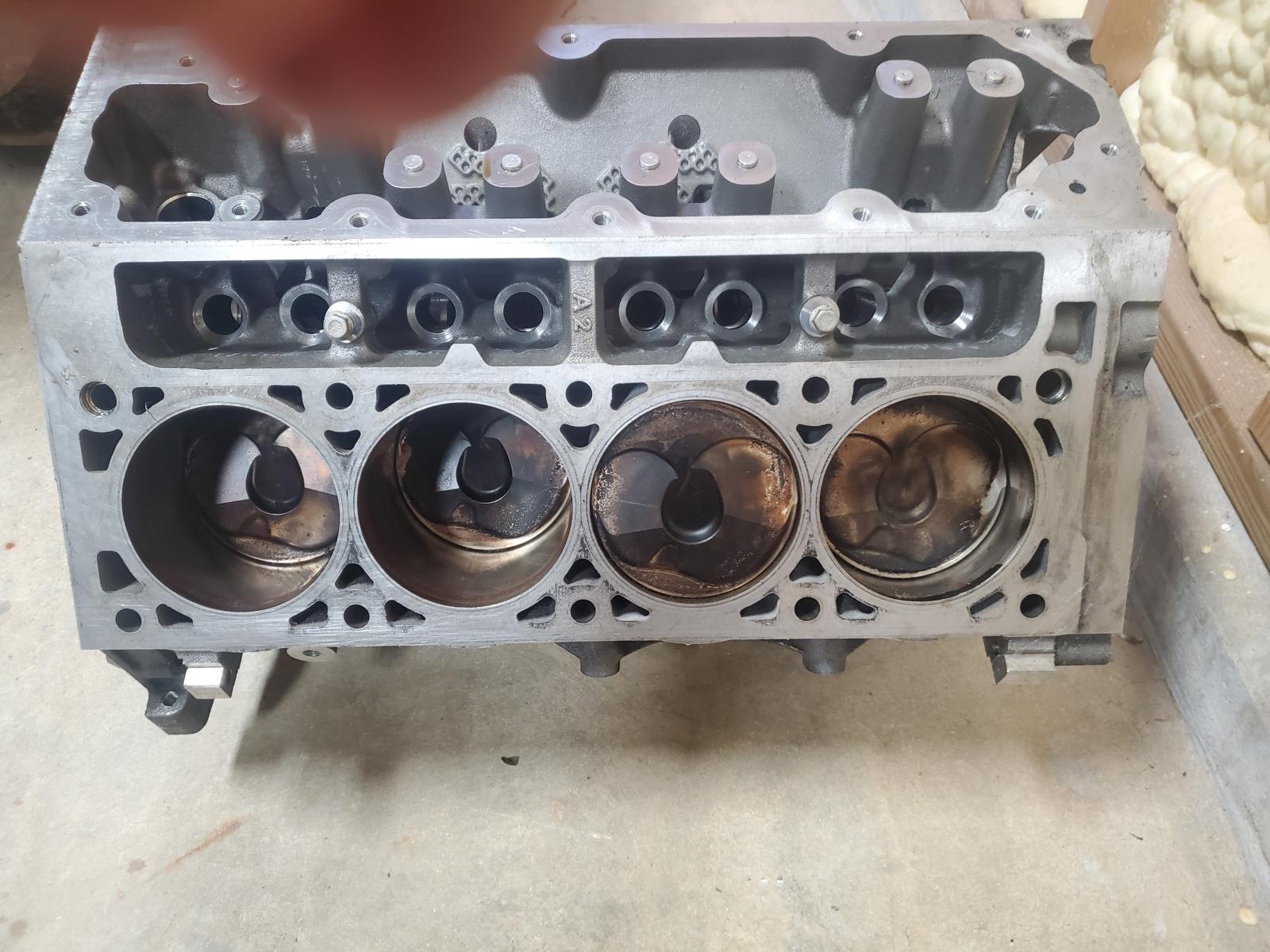

So I bought a drop in standard compression pistons and rods from gpi. Got everything prepped gaped rings to 22 thou per Kevin at gpi.
By the way I was dumb enough to think these pistons came with total seal rings because they put that chart up as a guide to gapping the rings. They are not total seal rings why use that as a gapping chart does not make sense to me but o well.
Put the oil ring in the bore just to make sure no gaping was necessary. Never seen an oil ring that did but I ck it anyway.
Installed all the rings and installed in the motor buttoned it all up. I will admit I did not spend a lot of time checking spinning ect the oil rings they installed fine it seemed. I spent a ton of time getting the 2 compression rings gapped exactly.
Every thing seemed fine. Did a break in about 75 to 100 miles a couple of heat cycles. Started doing hits and kept coming up with misfire on number 8, 30 to 66 misfires. Got random misfire ck engine light. Never had that problem before.
Kept chasing number 8 changed plugs twice regapped changed plug wires swapped injectors around coils around ect to no avail still number 8 and plug looked perfect.
So doing a hit I noticed smoke out the back in the mirror. The car was smoking like an old car that never had the oil changed. It used 2.5 quarts of oil in 400 miles.
So Found number 7 plug black. So that’s where the misfire really was and nothing left to do but take it all apart again!!!! Gueerrr!!!. Its a lot of work and a lot of time.
I found number 7 piston with the oil ring stuck to the piston. Number 3 oil ring was slightly sticky. I was able to get the ring unstuck but could find no reason why it was stuck.
bottom line these two pistons have too small of an oil ring land. All other's seem fine not sticky and can rotate freely and compress no problem.

So I worked with these pistons for I don’t know a few hours trying to figure out why and how to resolve it. I can not figure it out. So I took the oil ring off the Wesco Texas speed pistons I had in the car, that were made for stock rods. The oil ring corrugated part is exactly 1 thou smaller thick wise than the Diamond ring. I micked it, its exactly 1 thou. That oil ring fits perfect and spins and is not sticky on either piston. Just pure dumb luck. Not that im lucky in the first place to have this problem to begin with!!!!

FWIW I’m running the GPI drop in pistons & rods (lower compression) and my shop was not happy with the rings they (GPI) sent. We ordered up different rings and they’ve worked perfectly. I remember thinking at the time: “Wait, I paid for brand new rings even though my new pistons already came with them?” Sucks to buy stuff twice. I didn’t push the issue since my shop is very detail oriented, but I guess now I see why they did that…. I’m glad they caught the issues before the engine got reassembled.
What do u guys think I should do?
I’d bet your “sticky” oil rings and those pistons have a clearance issue.
1) The radius in the OD groove is too large and/or the chamfer on the oil ring is too small.
2) The diameter of the OD groove is too large and/or the ID of the oil ring is too small.
3) The OD groove width is too small and/or the oil ring is too thick.
My 40+ years as a machinist says that I’d be checking all of the relevant dimensions and making blueprints of the results. Optical comparator, CMM, OD groove mics, and Johansson (Joh) blocks are minimum to get the dimensions.
Somewhere there’s something that was either engineered wrong or it wasn’t made to the engineering drawing.
The lead time for one offs in our shop is 4-6 weeks. Subcontracted machine shops also have the same lead time.
It’s a long time to wait for shipping and manufacturing. Add your frustration, time and labor into the mix and you have more invested than GPI or Diamond.
I’d present the error to GPI and have them take it all back and give you a refund or replacement parts. Basically a new set of drop-ins and rings that work.
If you learn nothing is dimensionally wrong with the parts you bought, than all of this means nothing.
