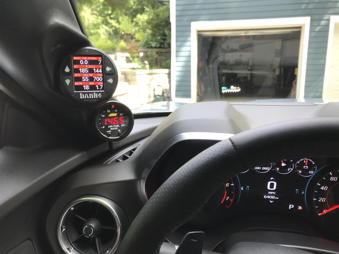

Here is the dual gauge pod:
https://zzperformance.com/collection...uge-pillar-pod
The iDash will read everything you asked for except AFR…you need a wideband as I mentioned before. Here is the one I’d suggest:
https://zzperformance.com/collection...-gauge-w-obdii

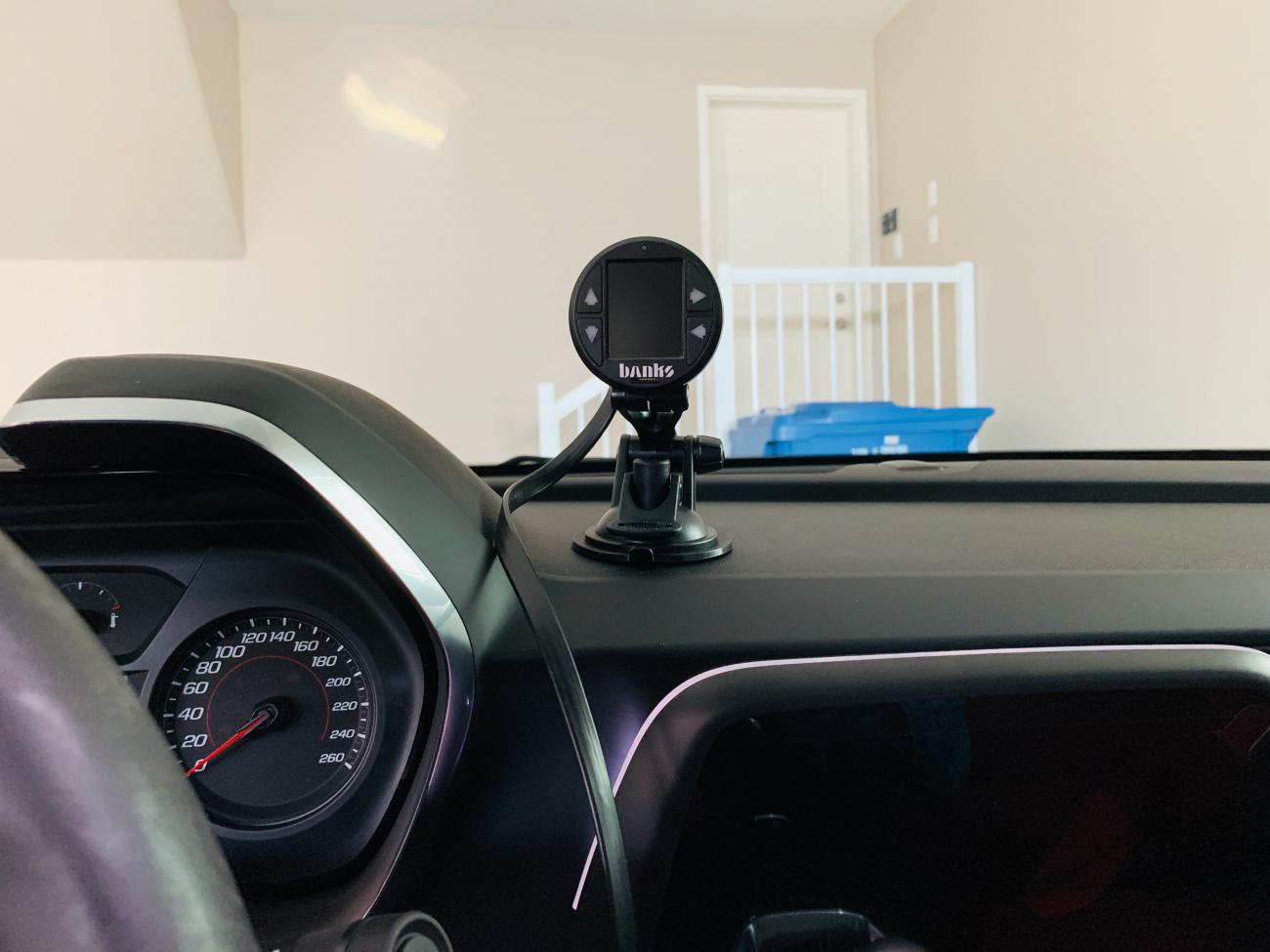

The Banks iDash DataMonster is the better solution for me for an unexpected reason: My only regular use computer is a MacBook! HPTuner requires a PC.
Although I also own a PC laptop, I hate using it, and don't bother to keeep it current with all the latest patches, because a Mac is SO much easier to use and maintain, and security is so superior.
The .csv file output from the DataMonster will load directly into my Mac version of MS Excel. No need to have a laptop in the car. I will be bale to look at the DataMonster during a logging ride, but then also be able to simply bring the micro SD card to my Mac, load the csv file into Excel, and analyze away. I already do something similar with the csv output files created by my LabRadar shooting chronograph. Very easy, and I can analyze the data in multiple ways.
The DataMonster is exactly the same size as the Supergauge, and so is completely inconspicuous, and no in-car laptop required at all since the DataMonster captures EVERYTHING I need, 20 times per second.
Because I will also want to use the DataMonster on other vehicles, with no extra costs or downloads required, I won't go with a pillar pod, but rather likely the Banks suction cup mounted holder on the windshield glass (better reliability of sticking there than to the dash).
This will be super easy for me.
I understand completely though why the HP Tuner approach works better for you and most other users. Just goes to show how it's nice to have choices.

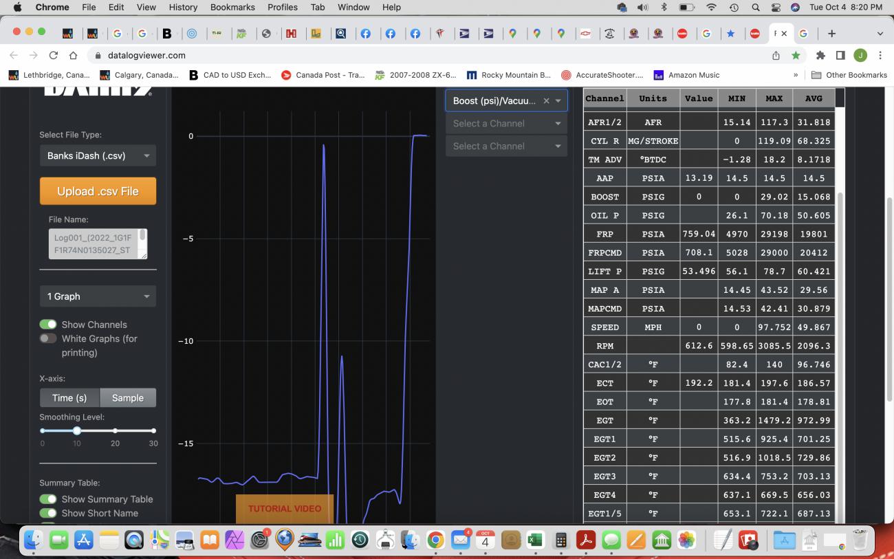

Smile Got the iDash DataMonster and installed
Ok, I ordered the iDash DataMonster from a truck shop a few hundred miles away yesterday, and it arrived today!
Got it installed.
Figured how to start a datalog on the included microSDcard, ran the car for a few minutes in the driveway while logging, and then uploaded into BOTH MS Excel on my MacBook laptop and to Bank's own free online data analyzer.
I realized a few things:
- The "owner's manual" is not very user friendly. Sure, it tells you all the steps, but you have to have a memory like an elephant to REMEMBER what to do next and when. This will take time to master, since my memry is not that great..
- Selecting "ALL" data inputs available for the datalog sample was a mistake. Way too large a forest to find the individual trees of interest! Have to be more selective next time . . .
- The free Banks online analysis tool seems far easier to learn quickly than the iDash owner's manual.
- This will be a super-powerful set of tools once I have learned, and memorized, enough of the owner's manual.
Jim G

Ok, I spent some quality time playing, and replaying, the Banks how-to-video that covers the iDash Supergauge and iDash DataMonster, and after enough replays of individual sections of the video, I got it!
I was able this morning to set up my 5-gauge normal display, that includes the parameters I want at this time wile I get used to the new superhcarger:Boost, RPM, FRP, IAT, IGN TM.
I also set up the parameters for datalogging as: Boost, RPM, FRP, SPEED, IAT, IGN TM. "SPEED" was not needed in the normal gauage display, as the car has both an OEM analog and a digital speed display. The addition of speed to the datalogging though is useful as otherwise there is no logging of that parameter, which is as useful as the TIME parameter when reviewing data.
I would have liked to see a "Gear" parameter in the datalogging, as the performance of the 10-speed automatic is impressive, and I would like to know exactly what gear it shifted to for any given moment in the datalog. For example, if you floor the accelerator pedal at 100 or 110 kph, the tranny shifts down several gears, but I'd like to know EXACTLY what gear it selected under a given set of circumstances.
I'm not complaining though, since for the Gen 6 Camaro, the Banks iDash and DataMonster make available 85 different parameters. That includes a number of parameters not reported to the OBDI port, as Banks adds a number of CALCULATED parameters intended to help you better understand what is going on in the engine and in the air it is breathing.
