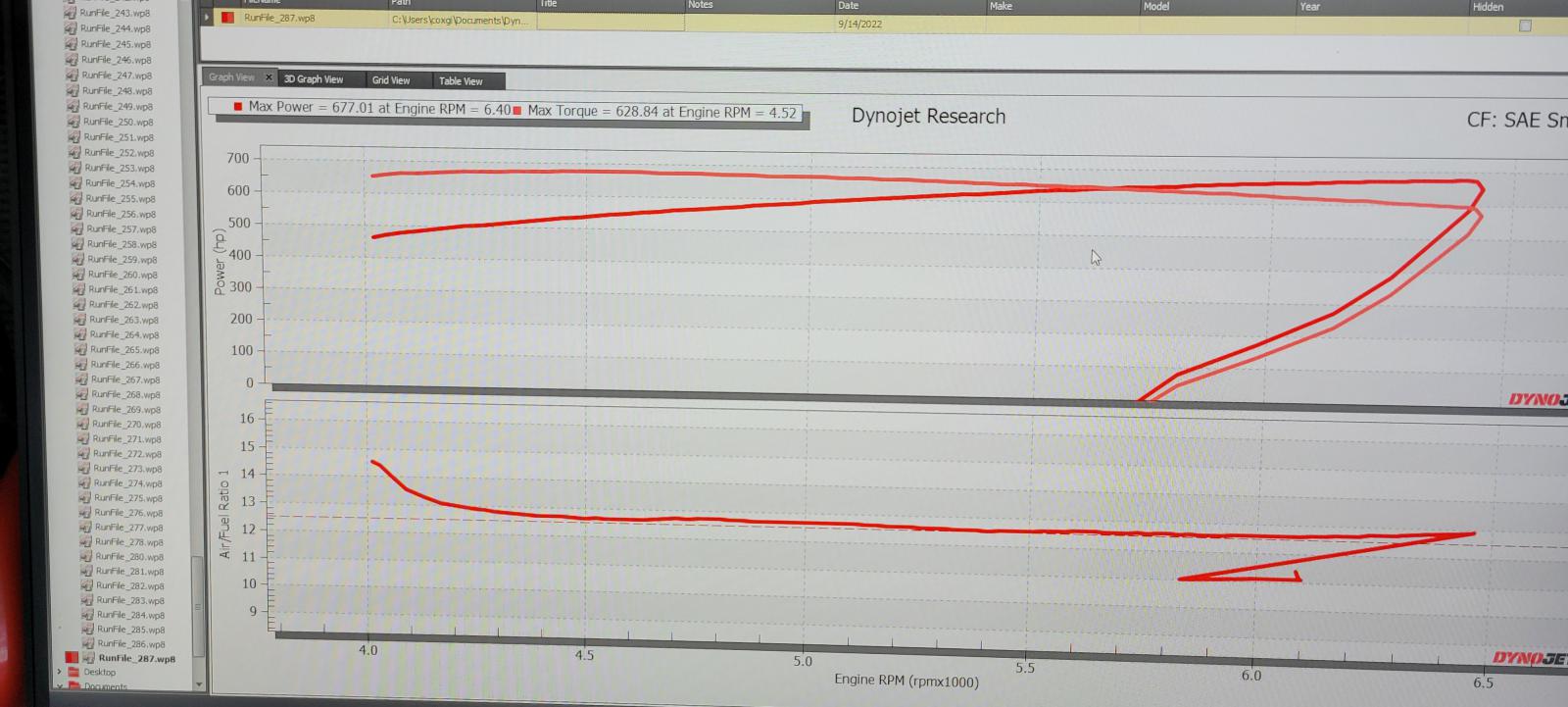

A detailed analysis of the before and after dyno chart that was generated for my car
I am going to right at the outset of this section of the posting say this:
The Davenport facility is located in Calgary, Alberta Canada, which is at an elevation of 3557 feet above sea level. Elevation above sea level strongly affects the performance of both naturally aspirated and supercharged engines, and affects supercharged engines much MORE than naturally aspirated engines.
Therefor, the dyno results we are about to review for my Camaro, done at this 3557 foot elevvation, are not going to be representative of the dyno results you or someone else gets at sea level or at any other elevation that is less radically high than 3557 feet. All other things being equal, my car would deliver higher corrected numbers at low elevations than you are going to see on this 3557 foot chart.
In addition, my car has the automatic transmission drivetrain. The results for a car with a manual transmission drivetrain would be higher because the manual drivetrain incurs lower overall driveline losses.
I say this now so that you realize that your focus should be on the DIFFERENCE between the baseline dyno results and the supercharged dyno results, not so much on their absolute values.
On the section that follows after this one, I will discuss the significance of the absolute results separately.
That being said, let’s now look at the difference between the baseline result and the supercharged results:
(see Photos 14 and 15 of the dyno chart)
The stock engine and automatic transmission driveline delivered 390 of the stock 455 crankshaft horsepower to the rear wheels.
That’s about 85% driveline efficiency.
This is a HUGE efficiency improvement over older automatic transmission drivelines. For example, my 2004 Chevy SSR automatic driveline only got about 77% of the engine’s crankshaft hp to the rear wheels.
So, the new technology 10-speed automatic is VERY efficient.
In fact, this automatic driveline is close to being as efficient as the also available manual transmission driveline, whose efficiency appears to be about 88%.
NOTE! All these transmission efficiency percentages are based on the assumption that all the dyno power numbers being compared are all fully and correctly corrected for ambient temperature, humidity, and air pressure, and all using SAE versus STD correction. However, large differences in altitude of the testing locations can sometimes give results not absolutely 100% accurate, given the current state of the art control capabilities. So, don’t take these efficiencies as “Gospel”.
Peak power at the rear axle (RWHP) increased by 42%, from 390 to 553 hp. that’s a 163 rwhp gain, and that is also a 42% gain.
That increased power peak occurs at 6380 rpm versus the stock engine’s peak at 5690 rpm.
And, with the supercharger, the power curve does not slope back down after hitting its peak, unlike the baseline curve which does start eroding very quickly after its peak. This shows that the supercharge ris fAR from running out of capacity.
Calculating back from this 553 rear wheel horsepower being 85% of the crankshaft power, it looks like the engine is now making about 650 crankshaft horsepower. So, in effect, the Magnuson kit allows a Camaro LT1 or SS owner to get the power level of a ZL1 without buying a ZL1.
CAUTION! Do not assume you are getting all the advantages of a ZL1 for less money than you would pay to buy a ZL1. The ZL1 has a much more robust fueling system and engine internals (e.g. forged pistons), and I think it also has some significant enhancements to its brakes, suspension, wheels and tires, and structure. And because of the superior fueling system and engine internals, the ZL1 can handle much more aggressive boost than an LT1 can safely take. But, if you never go to a track, and 650 crank horsepower is sufficient to satisfy your Testosterone level, or you already have an LT1, the Magnuson kit is a good deal.
The SMALLEST measured power gain was at 2500 rpm, where it was a 27% gain.
From 3000 rpm to 5500 rpm, the gain ranged between 32% and 35%.
Another useful metric when looking at dyno curves, is to calculate the “area under the curve”. This is very useful, because some engine mods, for example cam changes, can produce very high “peak” power, but can severely degrade power at other rpm points. A dyno curve with more area under the curve, versus one short high peak, will often enable its vehicle to out-accelerate a vehicle with the wild cam. This factor also gains importance when the number of available transmission gears is low, and loses some of its importance when the number of available transmission gears is high.
Also, an engine with a wider powerband is going to feel much better in non-aggressive driving, which is most of the time.
You can determine the are under the curve on a paper chart or image easily by simply “counting squares”, and then comparing the number of squares for the dyno curves being compared.
In the case of my Camaro, the supercharger increased the area under the curve by 36%.
So, in terms of AVERAGE improvement in power across the entire working rpm range, the supercharging made the engine about 36% more powerful. That’s pretty impressive, given that the actual boost level at the 3557 foot elevation is notably lower than the same car would show at a lower elevation.
This is a phenomenal power increase attained without stressing any of the OEM components significantly!

One more important comment on the dyno chart: Those of you with a sharp eye for detail, who actually examine “the fine print” on a dyno chart will note that the chart has been corrected to SAE standard ambient conditions like it is supposed to be to make it usefully comparable to other charts made at different geographic locations or simply at different times at the same dynoing location. This makes dyno charts truly comparable.
There are 2 different formulas used for this correction to standard conditions; SAE and STD. The SAE correction formula is viewed by professionals as highly preferable, as it corrects to much more realistic conditions than the STD formula. It almost always generates horsepower and torque values that are a few percent lower than STD numbers. Good performance shops use SAE correction, while shops that want to make their clients feel better about their car’s performance sometimes use the STD standard, and many clients don’t know the difference and feel better seeing a higher number.
Most of the time, for dyno runs made at reasonable elevations and normal temperatures, humidity, and air pressures, the correction factors tend to be small, most often 5% or below.
However, at very high elevations, or very high temperatures or particularly dry or particularly humid air, these factors can go pretty crazy.
In Calgary, they DO go VERY crazy. If you look at the bottom of the dyno chart for my car, you will see that the correction factor was 1.14 (i.e. the raw data is changed by 14%)! I was stunned by that when I saw it, because I’ve never before had a car dynoed at very high elevation. But Steve assured me that this is perfectly normal for Calgary. The correction factors seen by his team typically run from 12% to 18%, because of the elevation and the high summer temperatures.
Now for me, that makes the corrected numbers challengeable, because while the correction formulas are good, they inherently assume that an engine can and will to get the best power it can out of a given ambient environment, good or bad. But engines cannot necessarily do that. Some engines simply do not adapt well to adverse conditions. Simple example: That’s why engines still, with all our current technology, run better in cold weather than they do in hot weather, as Steve pointed out in the quote earlier in this posting. So, don’t get too hung up on the exactness of the numbers.
Here was mine from a couple weeks back, no dip. Not sure why yours did that, maybe the throttle closed, just not sure. I would ask them what they thought.

Maybe cat over temp stepping in.

Attachment 1110213.
The current posting thread on "Dip" on this forum, started by Kerry, mentions a couple of times within it that the dip is caused by the oil pump solenoid clicking on, and that it seems to be related to engine temp, as it can be made to disappear by cooling the engine and doing another run. No better explanation on why the solenoid clicks on and what that does, but hopefully someone who knows the details can chime in.
Jim G

Beats me, haven't seen it in any logs on any of my Lt1s. No help here
