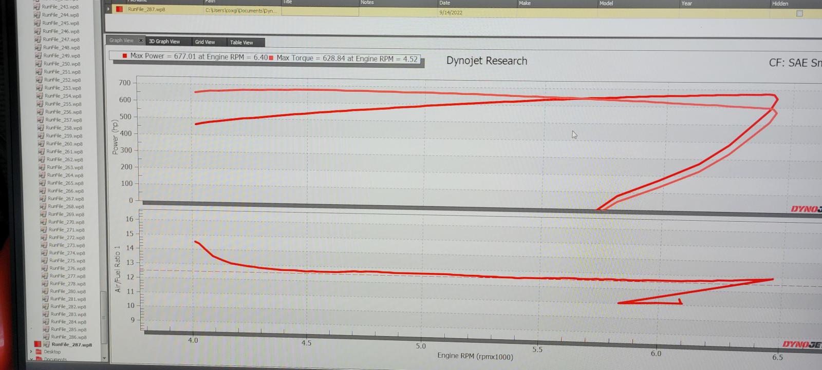

First pull it made 632/550, kpa was 156 or about 8.2 lbs of boost. However the boost gauge was 9.5 at the blower.
Size:  232.0 KB NA 11.64@120
Size:  134.5 KB Blower 105 mm pulley 10.34@135 at LS Fest.
Size:  129.2 KB w98 mm pulley, ET/MPH to be determined in October at my next outing.

I think those are great numbers maybe not as much as u were hopping. Am I seeing afr about 13.0 at wide open?

I run drag radials on the street already. This car will never see a street tire on the rear. We made a couple more pulls that were almost identical to the 677

Right at the peak, we fixed that and the highest is right at 12.79. Had a little knock and fixed that although Mike thinks it was not real knock. Did a couple pulls after the 677, one was 676 and the other was 675 but we didn't really cool down after the corrections and engine temps were higher then the other pulls. Yes they are the Nitto 555r2s which is the latest version of the 555. They are 305 35 20s
