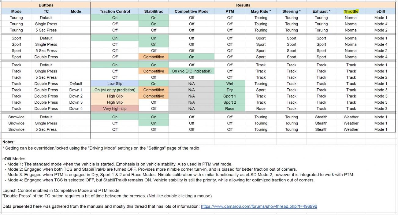

We used to believe that the throttle lag, not allowing thr throttke to snap closed has s function to improve emissions.
Sport and track definitely are not the same throttle mapping.

Yeah you guys are correct. It was late- I wasn't thinking correctly. Tour and Sport are the same map and Track is different (as is snow/ice).
I have mine set up with 2019+ Track mapping in both Track and Tour/Sport.
I stand by my position that the suspension contributes to what some might be feeling on a standard non 1LE car. Since my throttle map is the same in Sport and Track, I can tell you that it feels different when I set the suspension to Track vs Sport and let off the throttle in both modes.
Believe what you want here. I'm just telling you my experience on my car. Obviously mine is not a 1LE

Actually, strangely enough, Throttle mode A,B,C are not labeled correctly. These are generic labels for all GM ECU's. What I have found tuning these cars is the following for ZL1's:
Map A is Tour/Sport mode
Map B is Track mode
Map C is Weather mode
Driver Demand for Map A and C is the same for the 2022 ZL1 1LE M6.
