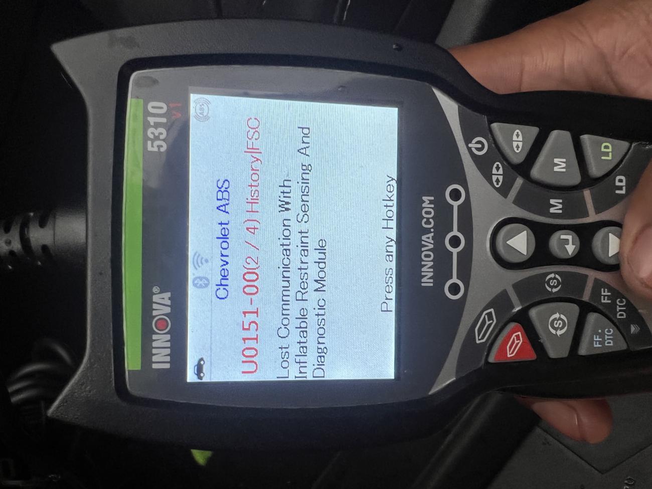

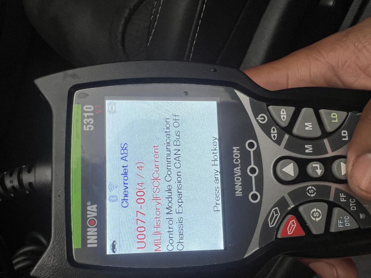

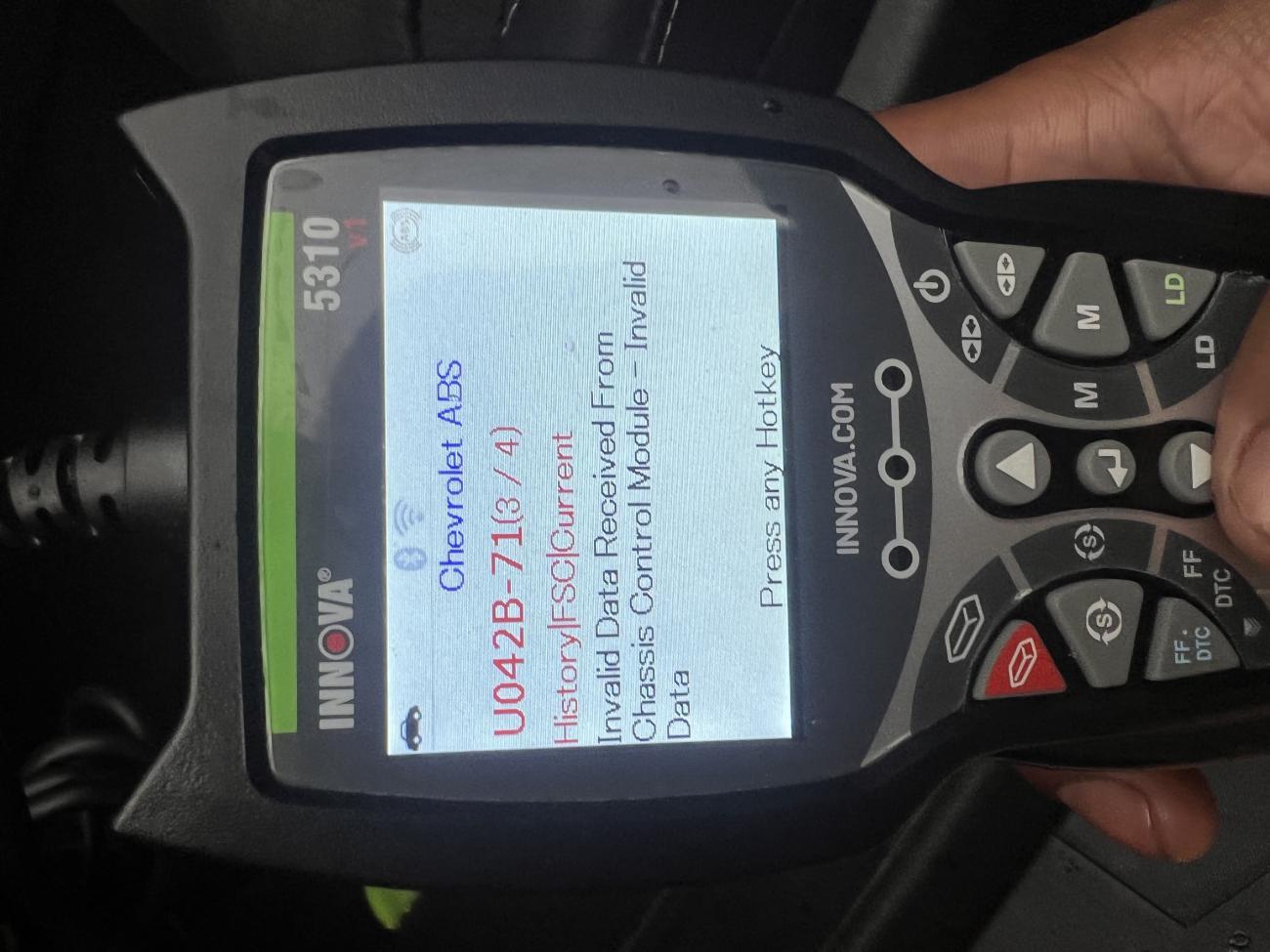

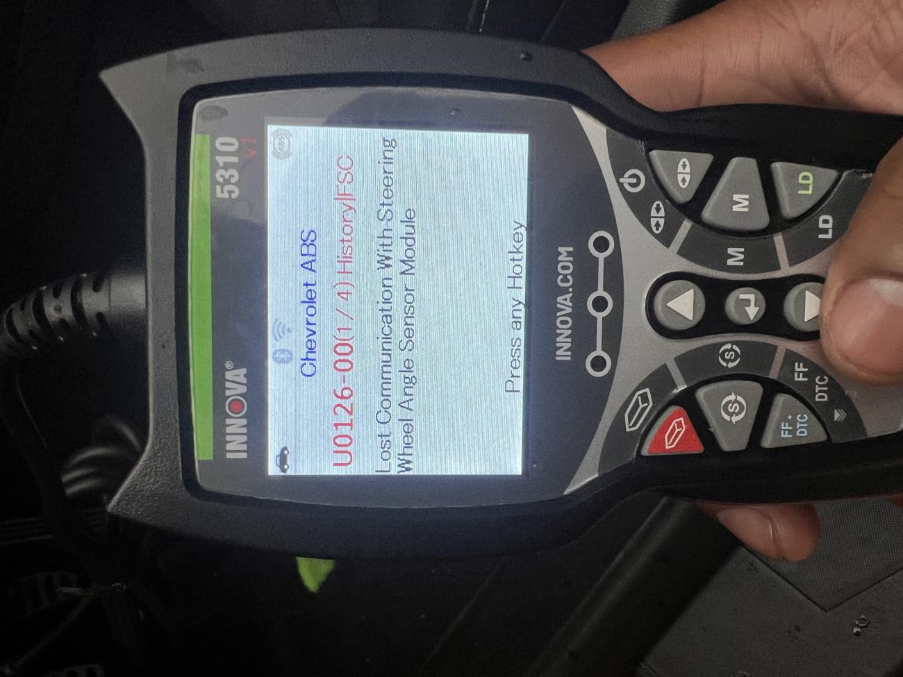

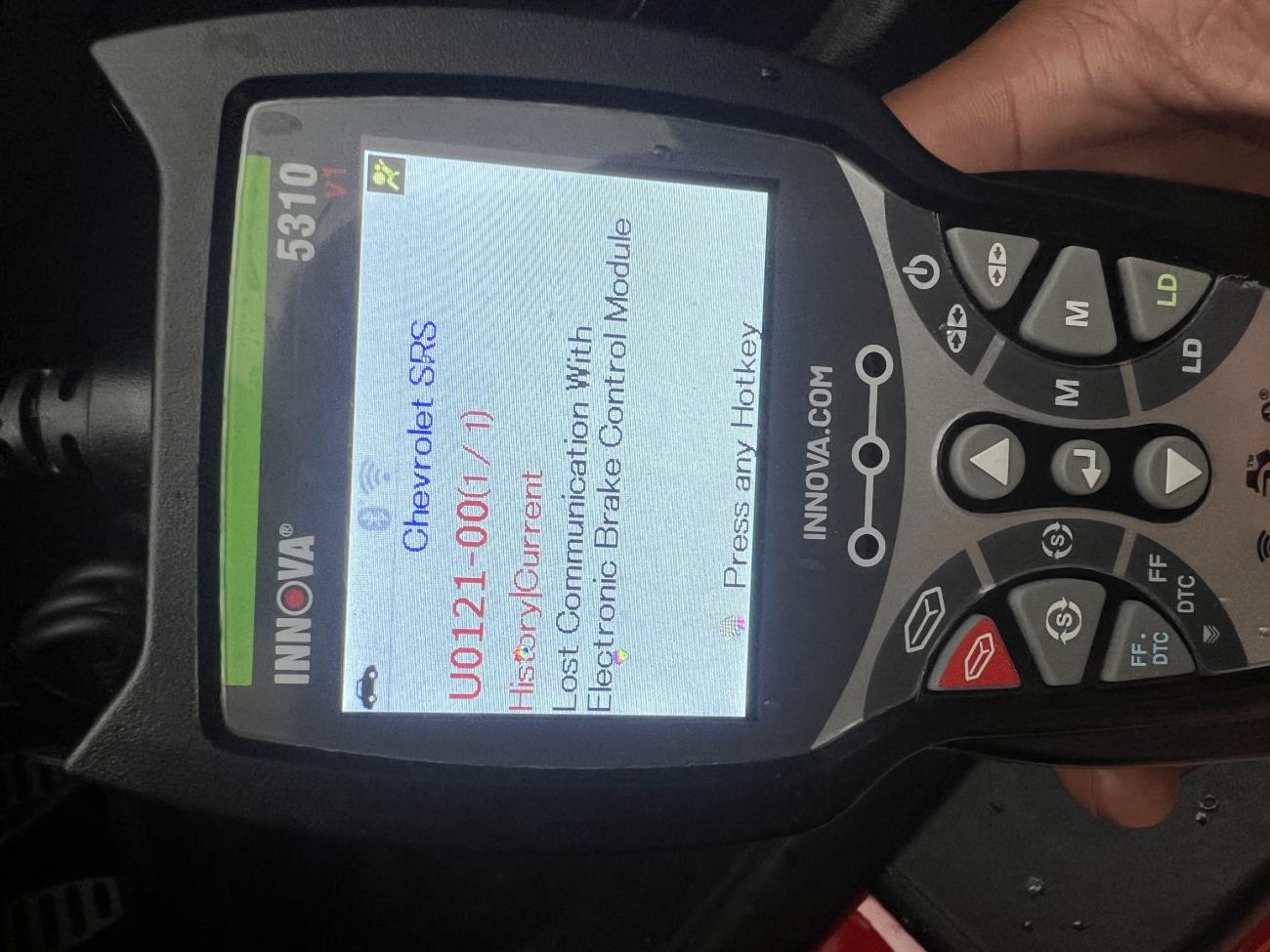

So I’m about a week into owning my first camaro, coming from a mustang. Amazing car, but I’ve got a problem. I’m getting a service stabilitrak, service rear axle, and “service power steering, drive with care”. It doesn’t always come on, but man when it doe, it doesn’t stop. I can’t even scroll though the menu to see my speed or mpg without it popping up. Power steering beeps when it comes on, etc.. anyways. I changed the battery, didn’t fix it. Checked the harness near the headers, it’s fine. Checked the harness above my driver rear tire, wasn’t rubbed through or anything as I saw, checked two grounds under the hood and they were tight. So, where do I go from here? Here’s 5 codes I’m getting if that’ll help anyone and thanks in advance!

I think all these codes mean a module is not reliably communicating with the BCM. It seems to be coming up that your ABS module isn't talking to other stuff.
