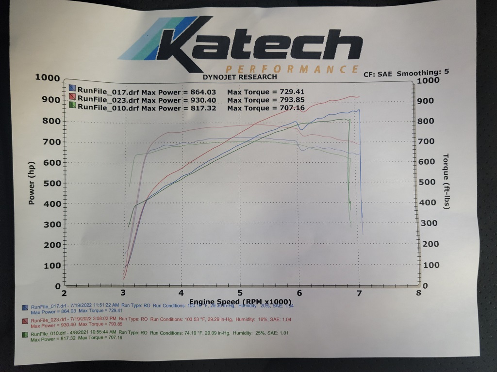

So ironically enough, I had this same exact conversation with my builder/tuner at Katech. I am picking up my ZL1 next week but I got the dyno graph today (see attached).
What I was told is this :
"That’s actually the oil pump solenoid tuning on. It creates a momentary dip in the power.
There are certain parameters that it has to hit for the solenoid to turn on. One is oil temp. If he cooled it down a bunch and made another pass it would likely get rid of that but it doesn’t effect power so there isn’t a need to do that."
From my understanding the car drives amazingly well & all other data that was shown during the tune is exactly where it's supposed to be. Katech has been nothing but stellar to this point and this is my 2nd round of mods to my ZL1 with them. The first time everything was absolutely flawless. We'll see when I get the car but I have zero worries and high expectations.
FYI, I have the Katech Billet LT1/LT4 Wet Sump Oil Pump in my ZL1 as well.

interesting great power by the way. Bet that car is a beast wow.
I notice that it happens right at the same rpm just after 6000.
thanks for sharing that. I guess mine is not the only one but I see tons like on youtube that dont do that.

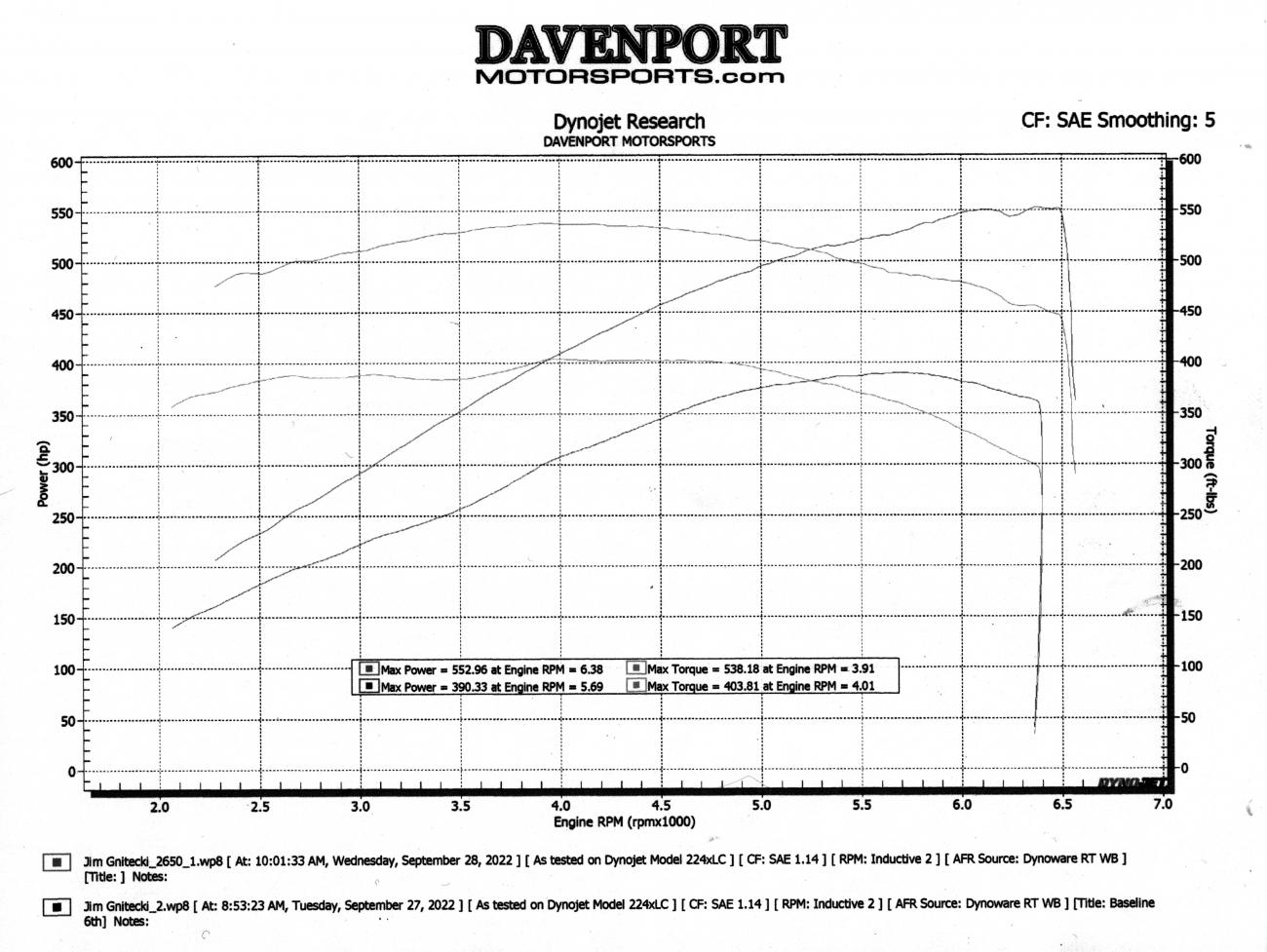

Old 10-01-2022, 06:59 AM   #14
JimGnitecki
Drives: Chevrolet Camaro LT1
Join Date: Sep 2022
Location: Alberta
Posts: 336
That dip IS there even on my 2022 LT1 that just got the 2650 Magnuson kit installed a couple days ago at Davenport. No other mods on the car other than the kit. Here is the dyno chart. Note that the run was made at 3557 foot elevation in Calgary, Alberta, Canada, and I'm not sure that the SAE correction formula can give totally accurate results at that elevation. (Note the obscene correction factor)
Jim G
