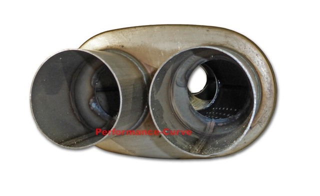

This is what you want in your mid pipe
Originally Posted by Katech_Zach View Post
https://www.summitracing.com/parts/j...4aAsryEALw_wcB
If you want something very similar to the magnaflow, but more of a true "x" insted of a Y-to-y connection internally. Just installed on a customer's ZL1 with ARH headers + Borla Atak (extremely loud). Now the car is very tame and tastefully loud. Jones-MF2469. It had no power loss when doing an a-b comparison compared to the unmuffled exhaust system at 860rwhp.
I will be installing this muffler on my personal ZL1 to try out with my ARH setup + Borla S-Type.
It is more of a factory style "stamped x" rather than an aftermarket "spliced-x" if that makes sense, but still an X and more free flowing than the magnaflow's Y-pipe setup.
We chose to install this in place of the ARH X-pipe that is up front. The packaging on this muffler is a little better than the magnaflow (slightly narrower), so it can be tucked further into the tunnel which is nice.
