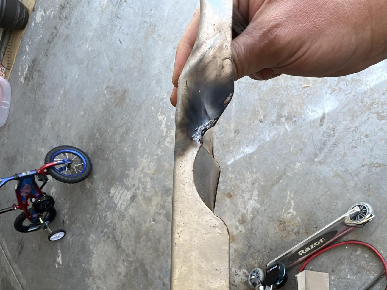

Did you figure this out yet? I am having the exact same issue as you. I replaced my 350 today and it popped again after trying to start the car. Has to be a short when trying to start. It started ran and tred it again and no luck. Has to be a short on something. I’m going to remove the heat shield off the starter and see what is up. But all the wires around the battery look good.

Here is the start wire that shorting against the starter heat shield

Should be just moving the wire away from the shielding. Everytime it hits the shielding and shorts then the 350A is blown I’d imagine

Yea I removed the shielding and will wrap the headers on that side location and get a starter blanket, should be problem solved. Gmpartsdirect has this fuse assembly for 67$
