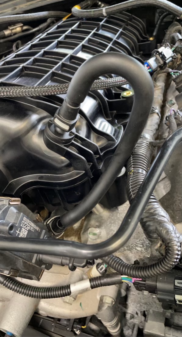

So I just remembered something as I was reading this. I have an LT2 intake and the PCV hose that attaches to it is in an awkward position. I had to sort of fabricate my own hose by attaching a longer hose to the quick release clamps because the OEM hose doesn't reach the intake mani. The issue I was then running into was that the hose I installed was rubbing against the hood because of the arch thats in it was too high. I need a 90 degree quick release to solve that issue but never got around to it. (see pic for reference)
Could this have anything to do with the issue?
bmatt777 is offline   Reply With Quote

This thread mentions possible problem of PCV hose getting kinked when you close the hood:
https://www.camaro6.com/forums/showthread.php?t=587617
If you still had the car I would suggest putting a dollop of shaving cream on top of that PCV hose and closing the hood. If you see a smeary mess on your hood liner you know the hood touched the hose and pushed it. The shave cream should be easy to clean off.
my guess is this car may work just fine in the shop with the hood open.
More posts commenting how the LT2 basically touches the hood liner when closed, and you have to modify the PCV fitting to prevent kinking of the hose:
https://www.camaro6.com/forums/showt...558640&page=19
