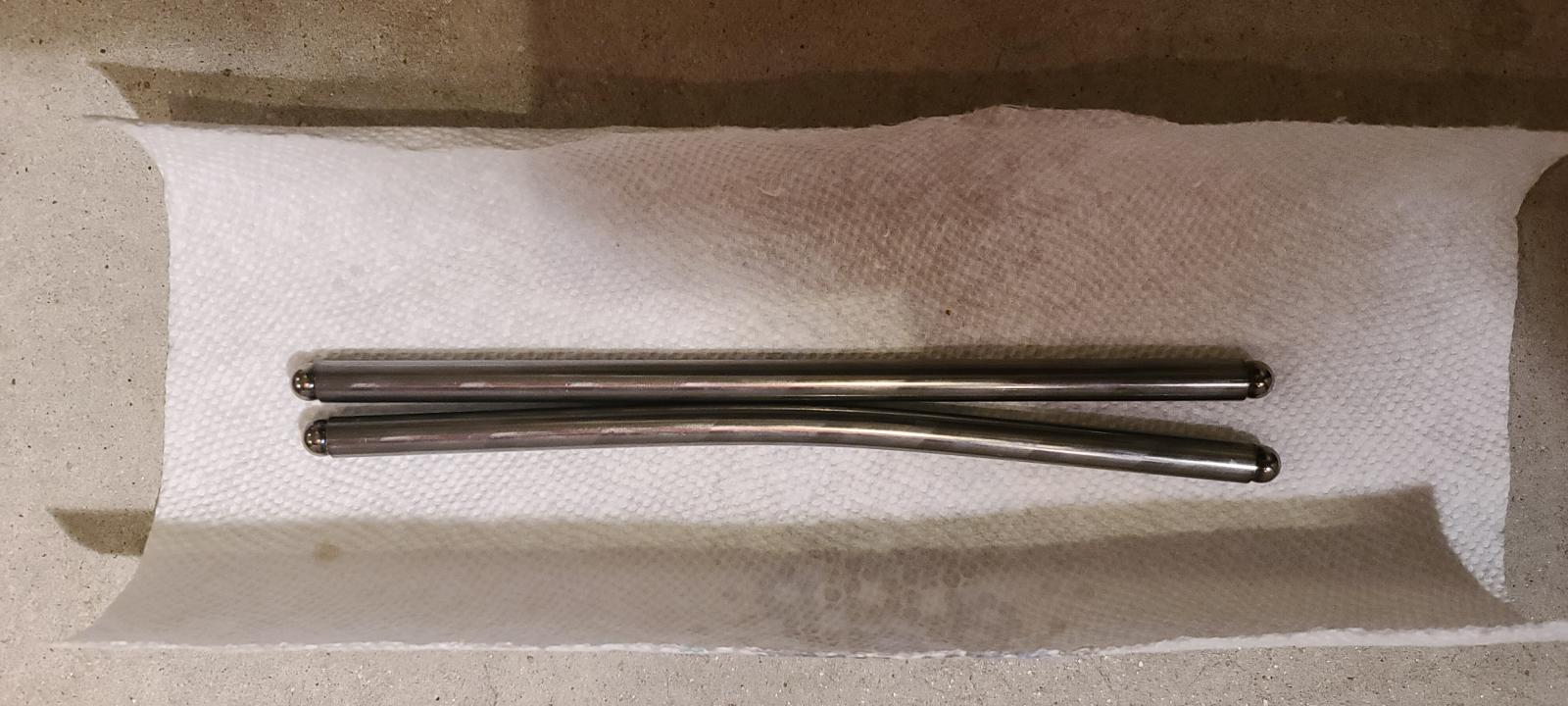

New update - pulled the valve cover tonight. Cylinder 1 had the black plug, that is left most in the videos. The front most rocker only moves when you first crank the car and then not again. Below are two videos, one full speed and one slow mo.
https://drive.google.com/file/d/1XyR...w?usp=drivesdk
https://drive.google.com/file/d/1Xvr...w?usp=drivesdk
Plug comparison pic attached as well

Looks like the motor is coming out
Probably threw a rod, piston hit the valve and bent your pushrod. I'm still wondering if these engines can take a beating or if this is just a fluke. 38k miles is low. I never track mine but step into everyday for short stretches and bang gears pretty hard. Have 54k miles on mine.
