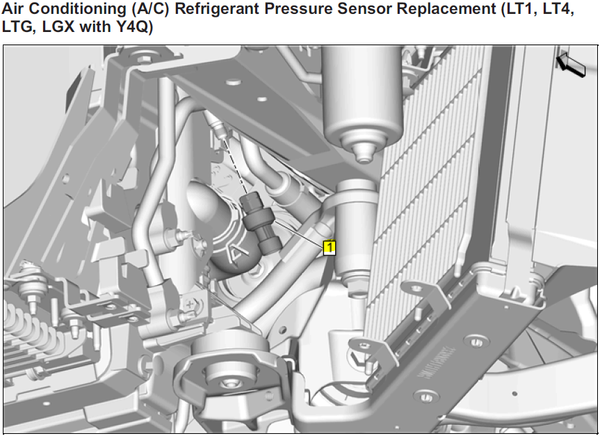

2. I doubt the A/C pressure is the cause, but still check the sensor connection near drivers side radiator side tank just below the air filter.

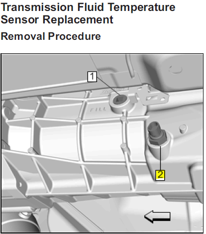

3. I doubt the transmission oil temperature sensor is the problem unless the dealership changed transmission fluid, but check the sensor connection.
