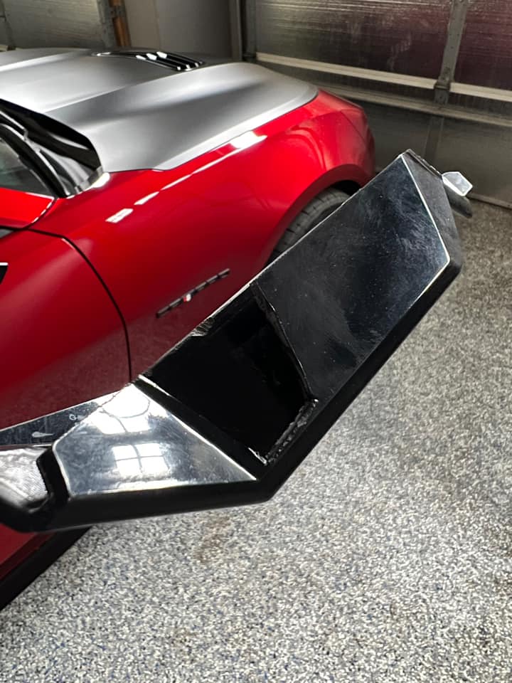

Well since I have a SS, the grill is different I guess. The part number for the tow hook cover is 84112297. PIC of it is FIRST pic below. The second pic is what the grill looks like WITHOUT the tow hook cover with the tow hook installed. I dont like the way the grill looks with that hole when the cover is NOT installed The PROBLEM with the way GM designed the cover is that the TOP grill bar lines up almost perfectly DEAD CENTER on the toe hook hole. There is a LITTLE flex with the grill bar but not enough to move enough to let that big assed thick stock tow hook thru so that it can screw into the receptacle hole. I will call ZL1ADDONS tomorrow and asked them about this. I would hope they would know or should know. I will update this post at that time

Well after talking to ZL1ADDONS , I believe you are correct regarding using the STOCK unmodified tow hook cover.
That is EXACTLY what I was looking for MSQUARED!!! I think I will go and buy myself a new dremel tool with a small cutter for this mod. THANKS for the post!!!
The PICS below are from LUAN's post on FACEBOOK link mentioned above. Thanks to him as well for the info.
