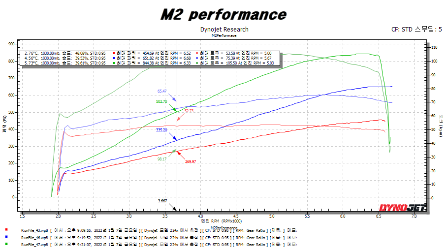

I am using it. It is quite nice for driveability and you can control the power with dial like pic.
shinysun is offline   Reply With Quote
