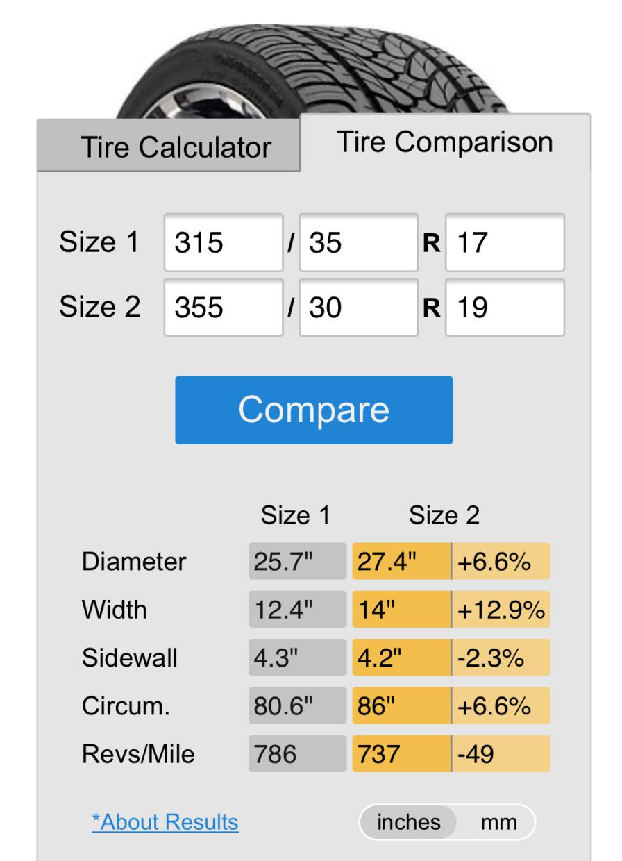

Also, for tire size comparison here are the numbers comparing ICTsccaCamaro‘s 355/35R19 to the 315/35R17 I want to use.
