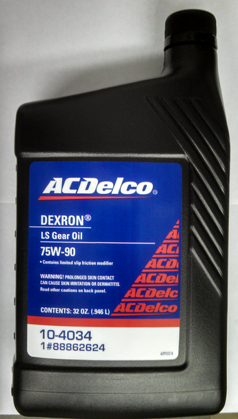

As per the owner's manual, the recommended rear axle fluid for your car is Dexron 75W-90 LS gear oil with the limited slip friction modifier, which is a far cry from the recommended automatic transmission fluid for the same car.
I don't know how much damage 139 normal miles on the wrong fluid can cause to the differential, but you should flush it out and fill it with the proper juice ASAP.
