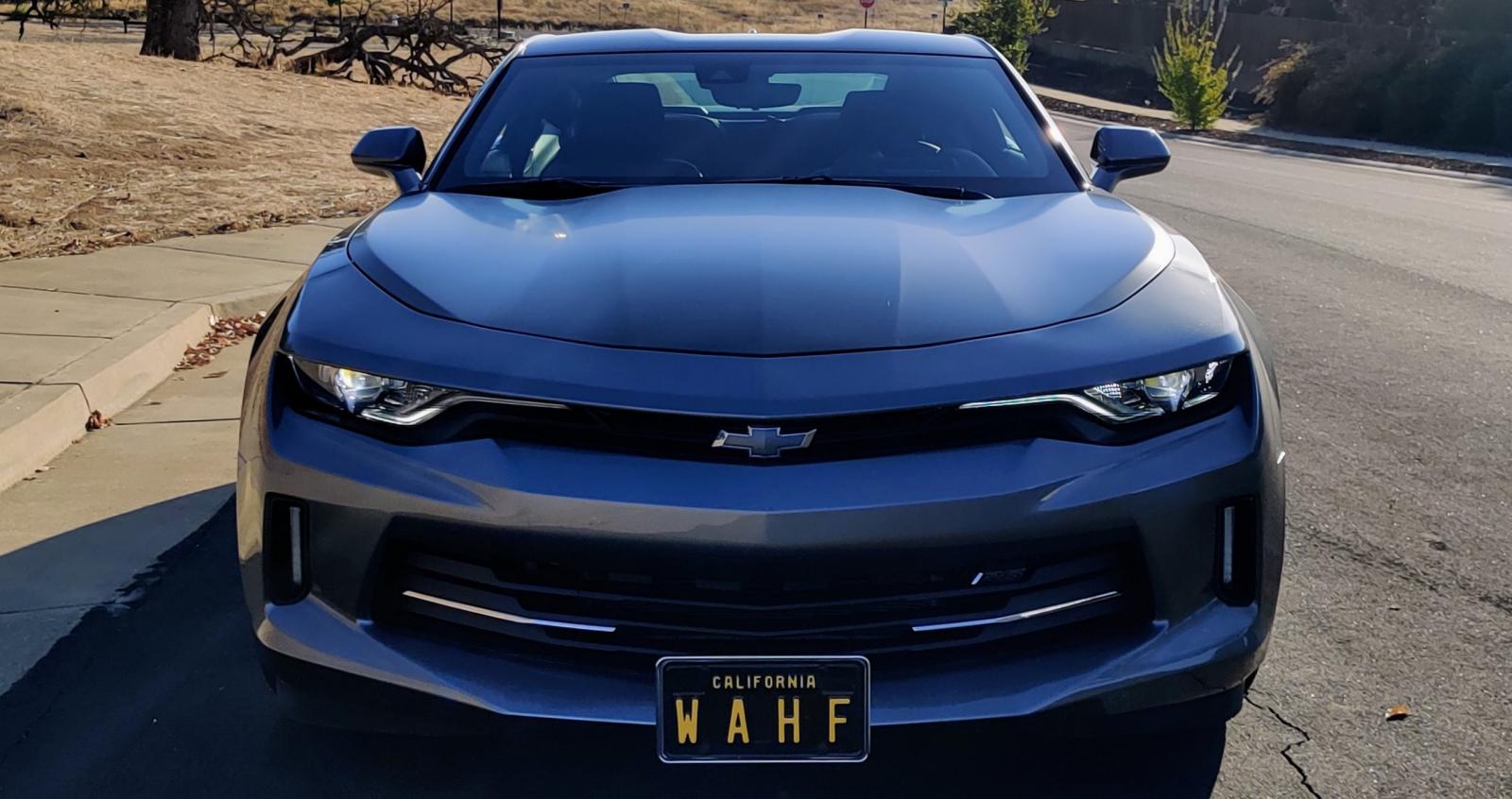

My '21 to '16 "de-fresh" is a front and back project...

Per Gen5DIY, the '16-18 headlights are not electronically compatible with the '19+ models. Given the different shape of the '19+ headlights, some creative bodywork will be required to adapt a '16-18 style bumper. My '21 is currently going through that process (see photo in the post above).

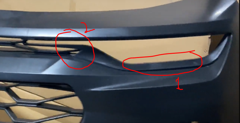

@The Maverick - drool that is what I would like to emulate, path of least resistance or not. It looks great from the pic, do you have more that you can post/share? And do you intend to post a guide on how it's going? I can't be the only one interested
To clarify, you mean section (1) is the area that would need to be filled in for 2019+ models and (2) is the area to be trimmed, correct?

No significantly different pics right now, unfortunately, and it is still a work-in-progress due to a COVID-influenced pace at the shop. I'll definitely share a more comprehensive overview once things are finished!
Your area (2) is roughly correct, but area (1) also extends up around the outboard edges of the lights.
