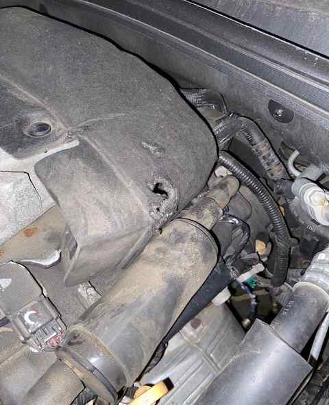

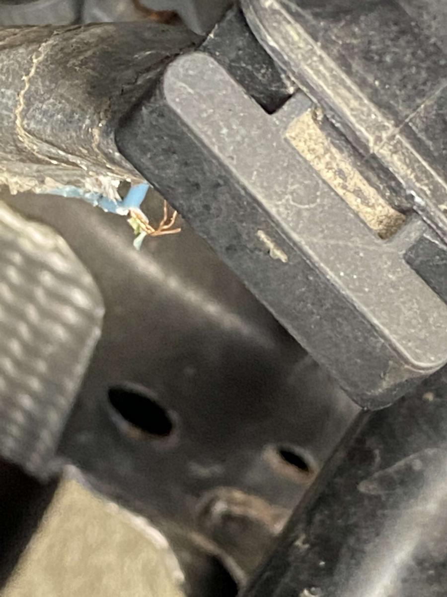

I replaced the MAP sensor but the codes were still there. The old one looked 100% fine visually. However, I found the cause.
Some "Mechanics" from youtube cautioned replacing the map sensor w/out inspecting everything else first including the wiring as the sensor can last the life of the vehicle. Unfortunately, I didn't do this so that was my naïvety.
Earlier, I noticed there was a hole in the padding and I figured the squirrel at my home got under the car and chewed it for a nest.
Well, you guess it. The squirrel chewed the wiring.
I can fix the wiring correctly and safely, not just "eh, tape it" method.
Hopefully nothing gets shorted until this is resolved but I'll update everyone to let you guys know what happened.

Looks like you have enough room to get in there, repair with some crimp connectors, and heat shrink as you go. Harbor freight has those supplies pretty cheap including a crimper.

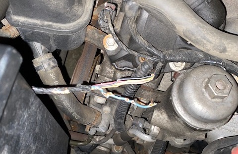

MUCH worse than I thought
Well, bad news...really bad news.
Apparently, the squirrel damaged not just that set of wires but bunch of wires along a path to get into the engine. This includes wires for the O2 sensor and the wiring harness itself.
The mechanic said its because the wire insulation is soy-based now but that was inconclusive since they chew on any wiring in the house.
I was told to take it to the dealer for something like this. I probably need a new wiring harness.
Is the dealer the only option?

How about a new oxygen sensor? They come with the wire attached.
Need better pix of any remaining damage.

To answer your question I think a normal mechanic can fix this. That being said I would actually see if your insurance would cover it. This isn’t a normal mechanical failure. This is mechanical failure due to vandalism (not sure if animals breaking your car is technically vandalism but you know what I mean)
