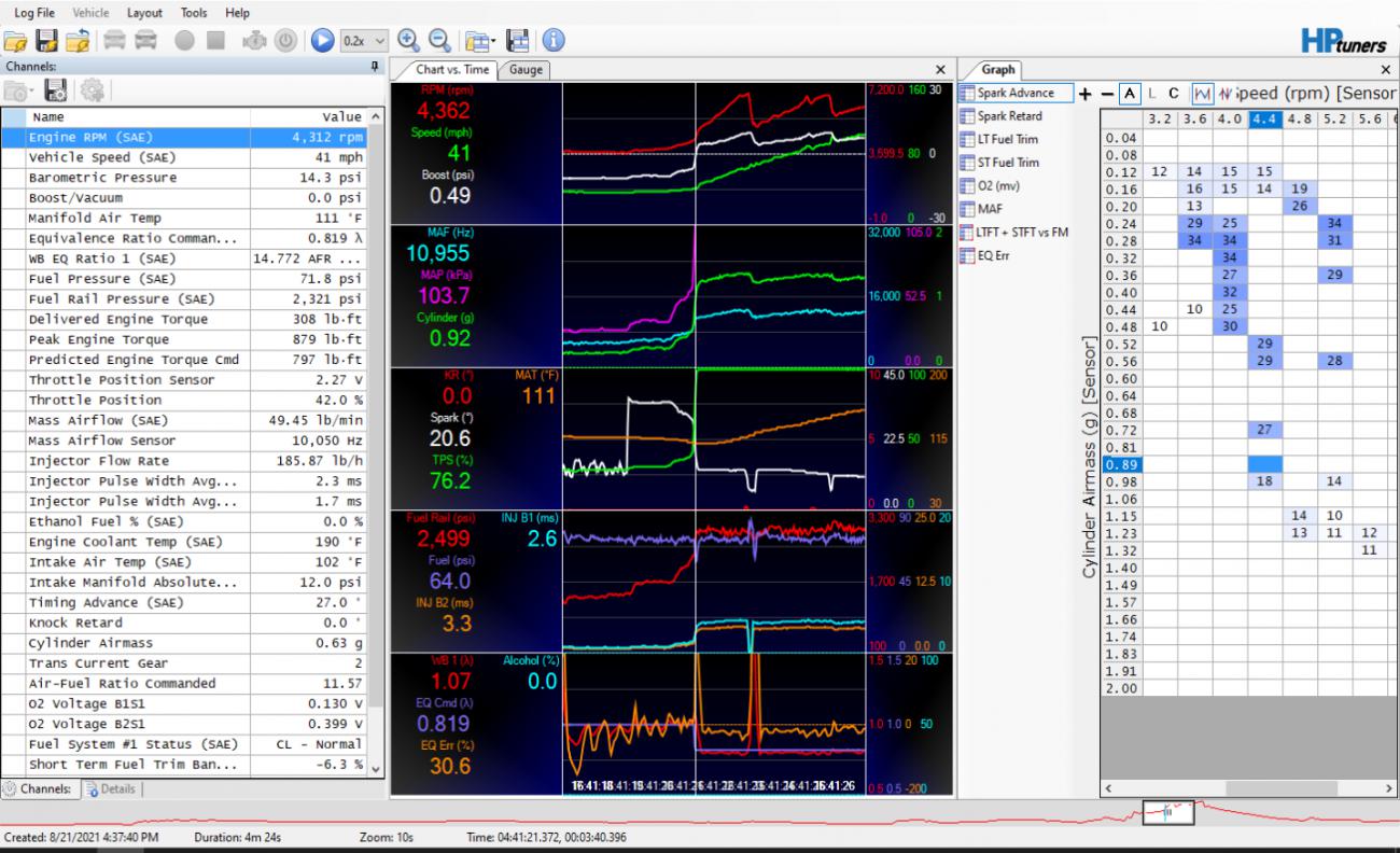

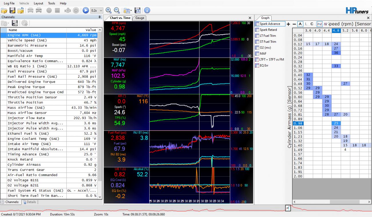

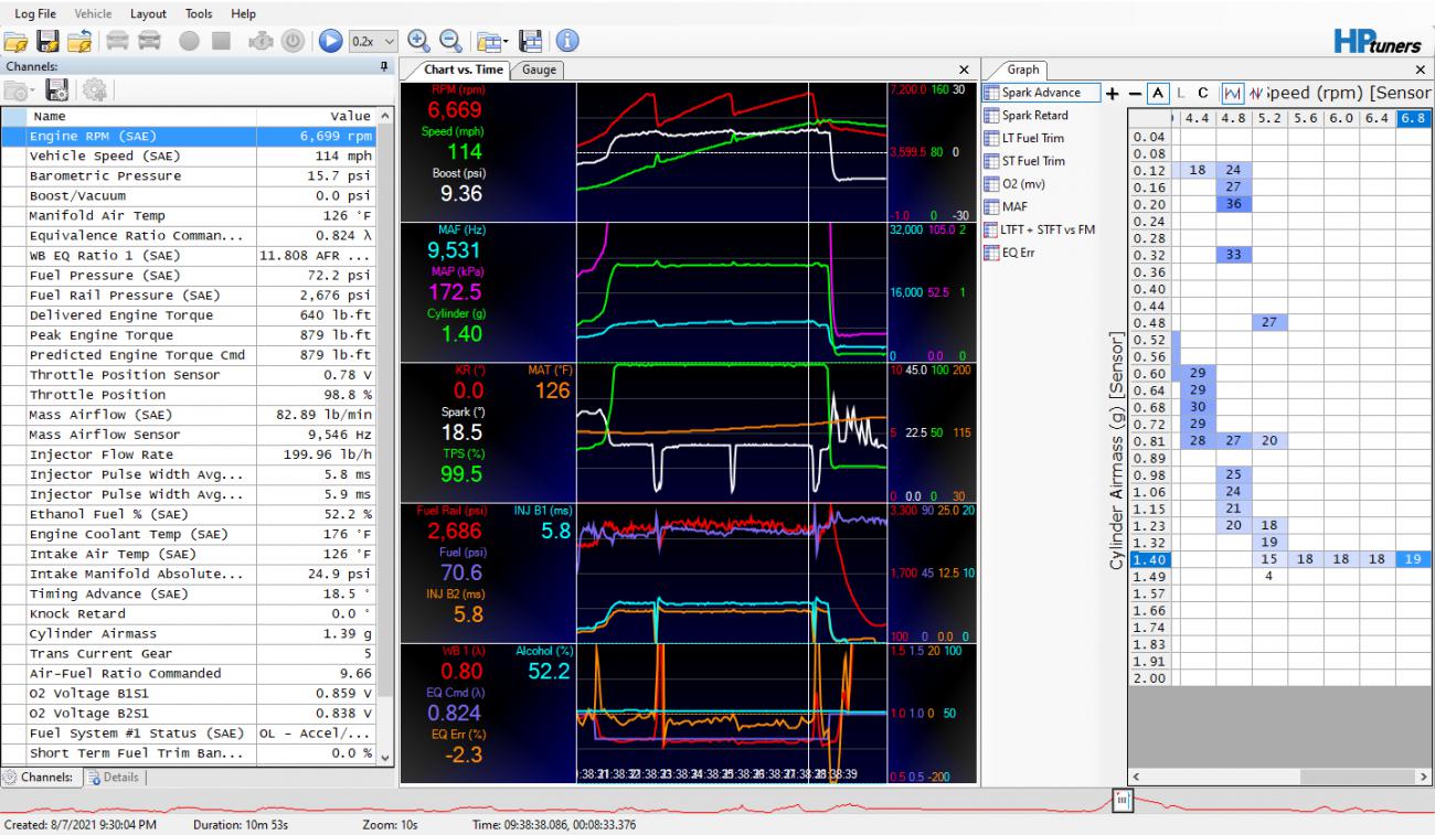

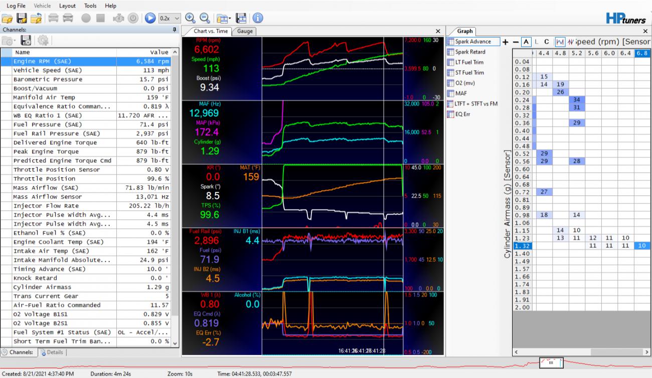

So often we hear the Centri superchargers run cooler then Positive displacement units such as the Maggie 2650 or Whipple 2.9. Well I was able to do get some data logs from 2 cars that have different superchargers.
A friend of mine just purchased a 2016 2SS A8 that has a P1x stage 2 intercooler, LT4 fuel system, and New Era cat deletes. It makes about 9.5psi in the heat @ 6600rpm. It is still running 93 octane.
My car is a 2016 SS A8 with a Whipple 2.9, 3.375 pulley making 9.5 psi @ 6600rpm in the heat, Fuel system, Rotofab big gulp, ported 95 mm tb, CA cat delete pipes, running E52.
What I found is both show similar MAT at the start of the run. Whipple is slightly hotter, however by the top of 4th the P1x is hitting close to 160 degrees and pulling timing. The Whipple is around 129 and making full timing. Post pull the P1x does recover a bit faster, but it still ends up around 155-160 by the top of 4th and pulling timing regardless if it's the first pull or 3 pulls later. The Whipple still hasn't got hot enough to pull timing. It was about 5 degrees cooler(85-86) on this log vs the P1x(88-90) but that wouldn't make enough difference to skew the data much.
Here are the logs:
P1x SS
Whipple SS
Just to be clear I am not biased to my Whipple. I was actually impressed with how the P1x works on the SS. We will be installing a flex sensor and running some E on it soon. This P1x car was purchased from a member here on C6. I retuned it and we were taking logs to make sure it was good. This log posted above was before I touched the timing. It had 13 degrees in it and it was getting a .5-1 degree KR. So I pulled it back to 12 degrees and it went away. I didn't post that log because we didn't pull it all the way through 4th.
Either way I just wanted to share some data. Folks often talk about IAT's this and that with these cars and the only thing that matters is MAT. That is what the ECU references when correcting spark vs air temp. Both cars are set to pull timing at 154 degree air temp and that is exactly what the P1x car does.

Looks like you started your Whipple run at a lower ECT than the Procharger run (by 21º). Would suggest running the Procharger car at lower temps like that too, for a resulting lower MAT. I had a Paxton before, and definitely when the car was running hotter, the MAT was higher.
