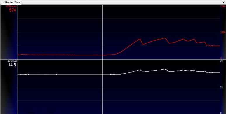

Simple, on a Procharger kit (ECS/Paxton or Vortech too) the MAF/IAT/BARO sensor is mounted after the compressor, not before it like with a roots style blower. This means that it's now subjected to varying amounts of boost, and therefore the baro reading from it is junk. Visual aid below, Paxton blower with sensor after the compressor like the kit has you run. Note how at idle, the baro reading basically makes sense for the 200 feet ASL that the car was at, but look how as engine rpm rises and therefore blower rpm rises too, the 'baro' supposedly goes up. This run the reading went up to 17.7psi at about 4100 rpm, baro readings are absolute junk in this configuration.
Attachment 1077939
Thank you for explaining that.....my LT1 is running much better than before after the baro breakout.
