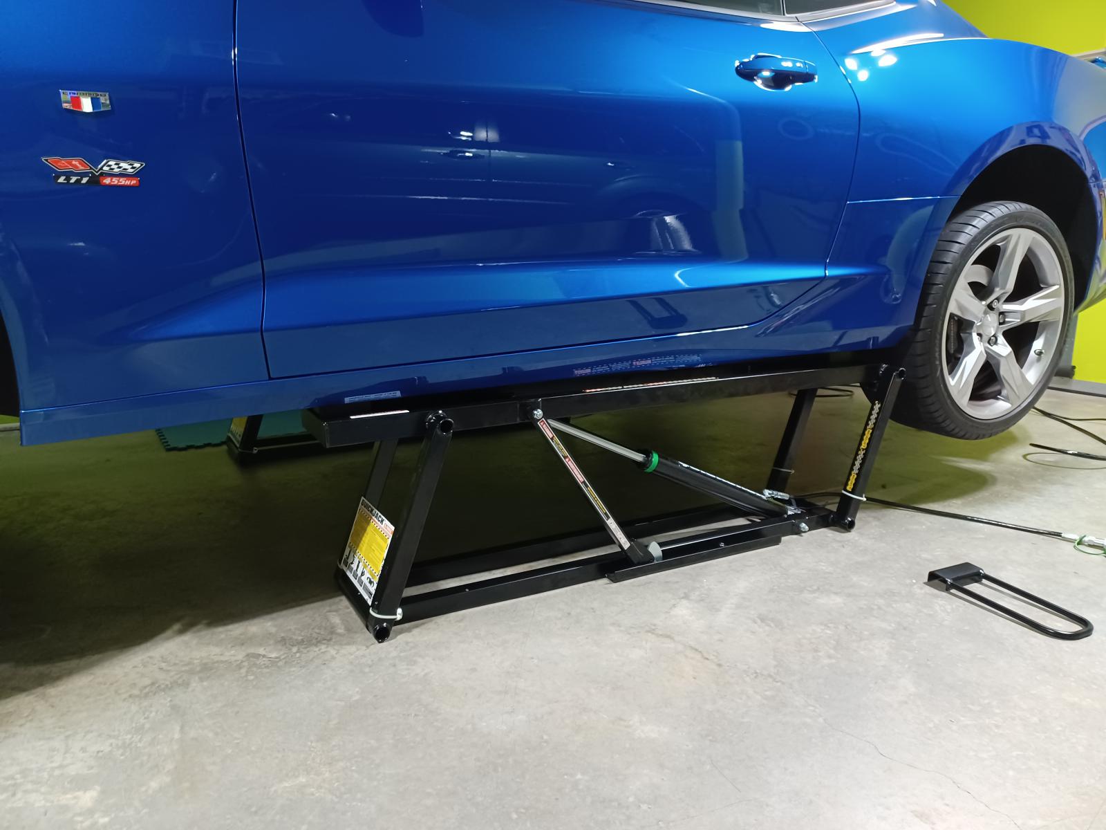

Got my quick jack bl 7000 slx. Jacked up my 2017 camaro SS, worked perfect. I have 3 bolt on aluminum pinch weld blocks on each side. From front to back I used the second one and the third one to lift it. I used the tall rubber blocks and placed the horizontal blocks. It's perfectly solid when in the air. I also zip tied 4 roller ball bearings to the frames to easily roll it under the car for easy storage.

Nice, I have the BL-5000SLX and do the same, the car is solid as a rock. In before the folks saying you need the EXT or you'll die. I purchased the extensions and have never needed or used them.

I have the 5000slx i bought for my mustang but never used. Thought they would be to short. You guys use the middle and back pinch weld locations? Wouldnt the front and middle make more sense?

There is 2 front and 1 back.

The nice thing about the EXT is you can lift it from the front and rear points. It looks like you can get by with the normal one, but my preference is definitely to have the car lifted from the front point to minimize how much of the car is cantilevered out.
