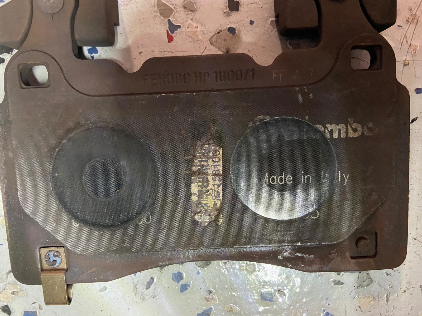

I was asking also about the KNS Ti shims. But in looking at the pics of my stock 4p pads, it appears there may already be a shim on them?

oh my bad didnt see that but yea they already have shims but the ti shims may not be needed on oem pads

The shims on the stock brake pads(and most aftermarket brake pads) are there for NVH, not for temp issues. So if you are worrying about boiling your stock fluid with the new pads, get the Ti shims.

Hey, OP. You have done all the initial stuff I would suggest when asking about pads and shims.
I would switch to a different pad before using the shims.
The Ti shims work. They will keep you from brake fade due to fluid failure, but make sure the fade you are feeling is fluid and not pad.
The shims aren't magic. The heat generated by the brakes is still there, but it's reflected back to the pad/rotor instead of into the pistons/fluid.
I found when I added shims, I started having pad fade which necessitated a move to a more racing oriented pad.
When I made the changes one at a time (and used a heat gun between sessions), I saw that perhaps all I needed to change was fluid. So I moved from Motul600 to SRF. Fade problem went away and I didn't need to use the shim.
YMMV
PS - it was mentioned above, but the metal plate on the back of the OEM pad is a backing plate, not a shim. It's to reduce rattle/noise.

Thanks guys, good info. In looking at the stock pads again, I see your point. It’s not for heat. I’ll switch from the motul 600 to Srf as well.
