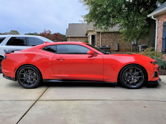

I specifically went with the Eibach springs on my ZL1 because the advertised drop wasn't as much as some other aftermarket springs. In my opinion, it sits perfect.
Can you post pics?

Originally Posted by Wuiquen View Post
Can you post pics?
Sent from my moto g(7) power using Tapatalk

That looks awesome... I agree the ZL1 doesn't have that much of a gap from factory. I wonder if I lower my car, will i have any issues since I have the ZLE wheels and the poke thru the fenders.
I mean anytime you mess with the car suspension you are changing the set up from OEM. Most of the time, people go too low on a lowering springs so the struts and shocks cannot keep up. Given that the magna ride can be readjusted for the new ride height, i would do that if i was to lower the car. This would allow the shocks and strut to function better.
