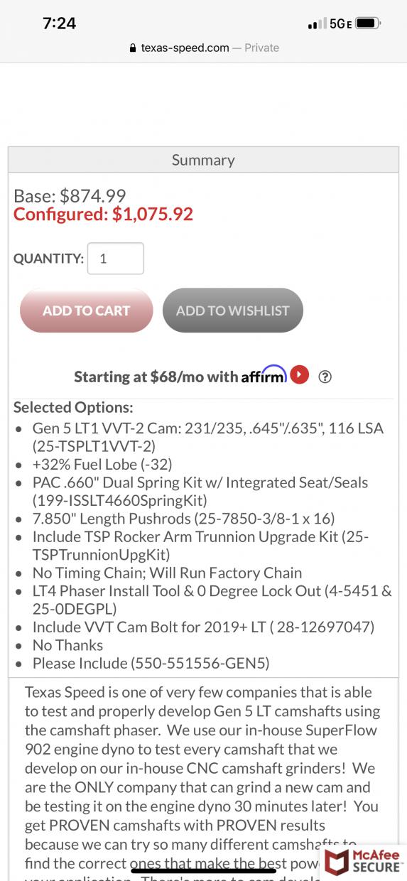

Hello this will be my first time ever modding a vehicle this heavily. Going twins on my ZL1 I wanted some tips/advice on my parts choice for going a turbo build on stock block/heads.
Turbo kit here: https://www.hellionpowersystems.com/...-turbo-system/
Intake manifold: https://treperformance.com/i-2389933...iABEgK62PD_BwE
Off the shelf cam: Name:  CF6B3AA9-A4C7-4DFD-8129-C9601065330C.jpg
Will this cam spec be fine for a turbo build and for stock engine components?

That cam is, not the best choice... Unless you are porting your heads, that is a lot of lift for very little gain (Stock LT1 and LT4 heads don't flow much more past .550 lift, in fact they only see an increase of 10 cfm from .500 to .550, and less from there) This will lead to beating the hell out of the valve train for no reason. Also the duration is high enough to affect low speed characteristics of the motor. That cam would work better in H/C/I car imo. I also agree with KingLT1, Cam motion has better cams for your application.
With that in mind with stock heads, which of these cam specs would you recommend? I have no clue how cam spec ratios work. I just want a cam to help with the higher fuel lobe %.

The 224/230 115 or 227/233 115 would be my choices. I wouldn't go larger unless you plan on going with a larger stall converter.
