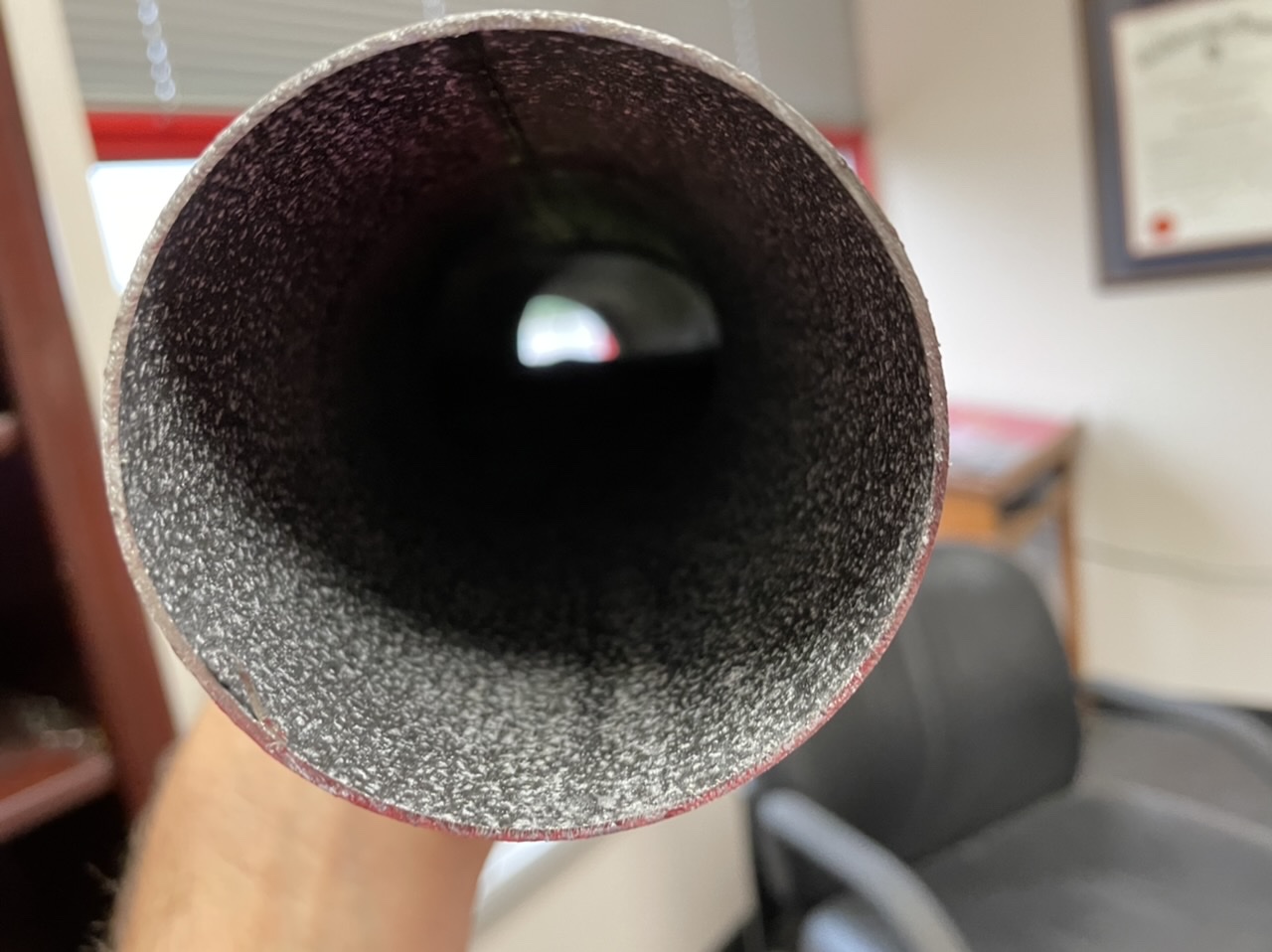

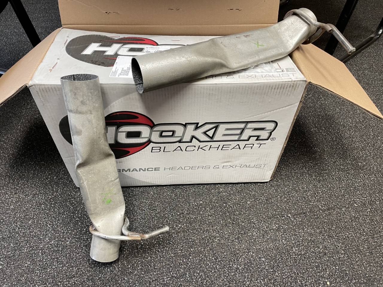

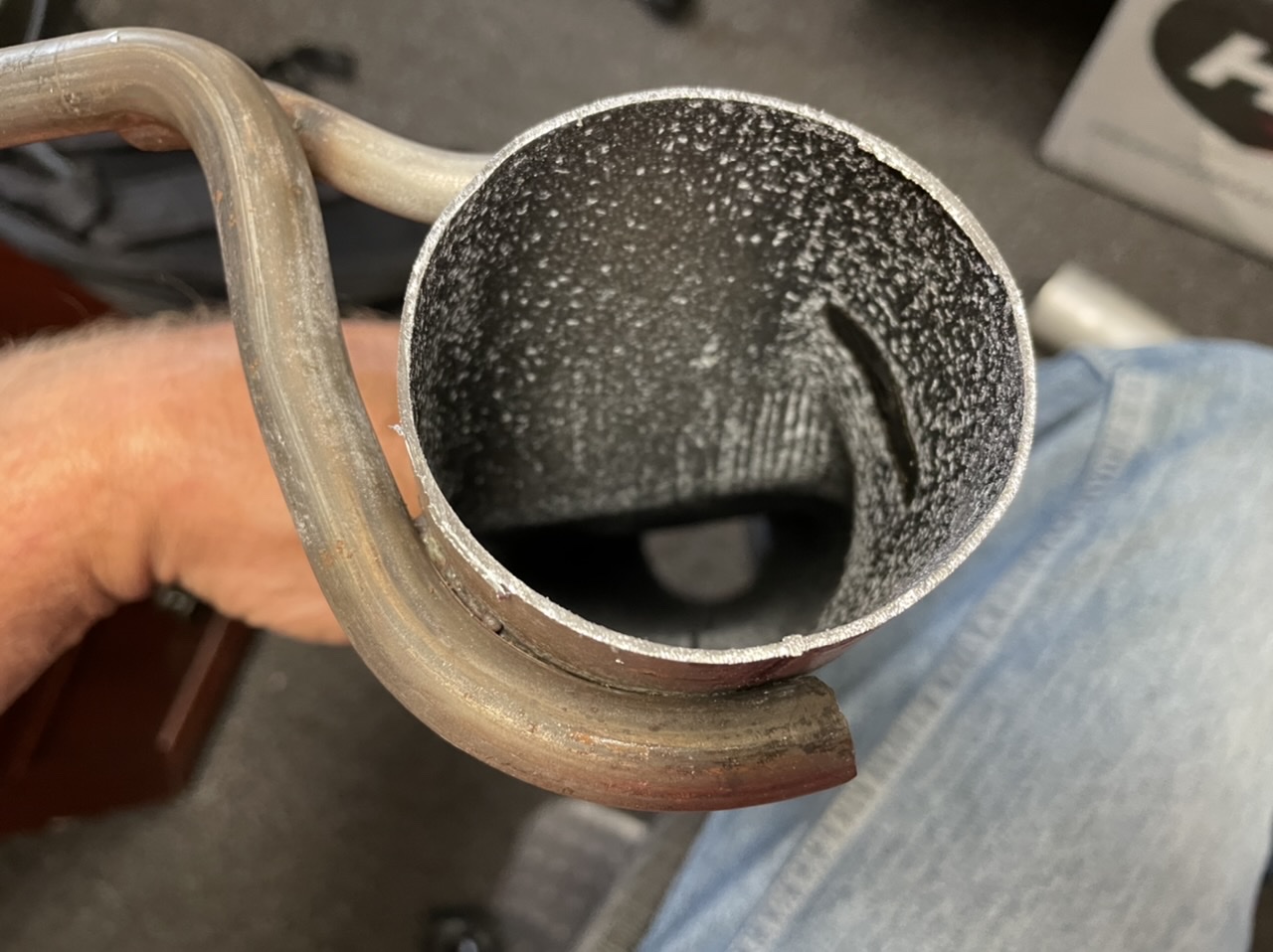

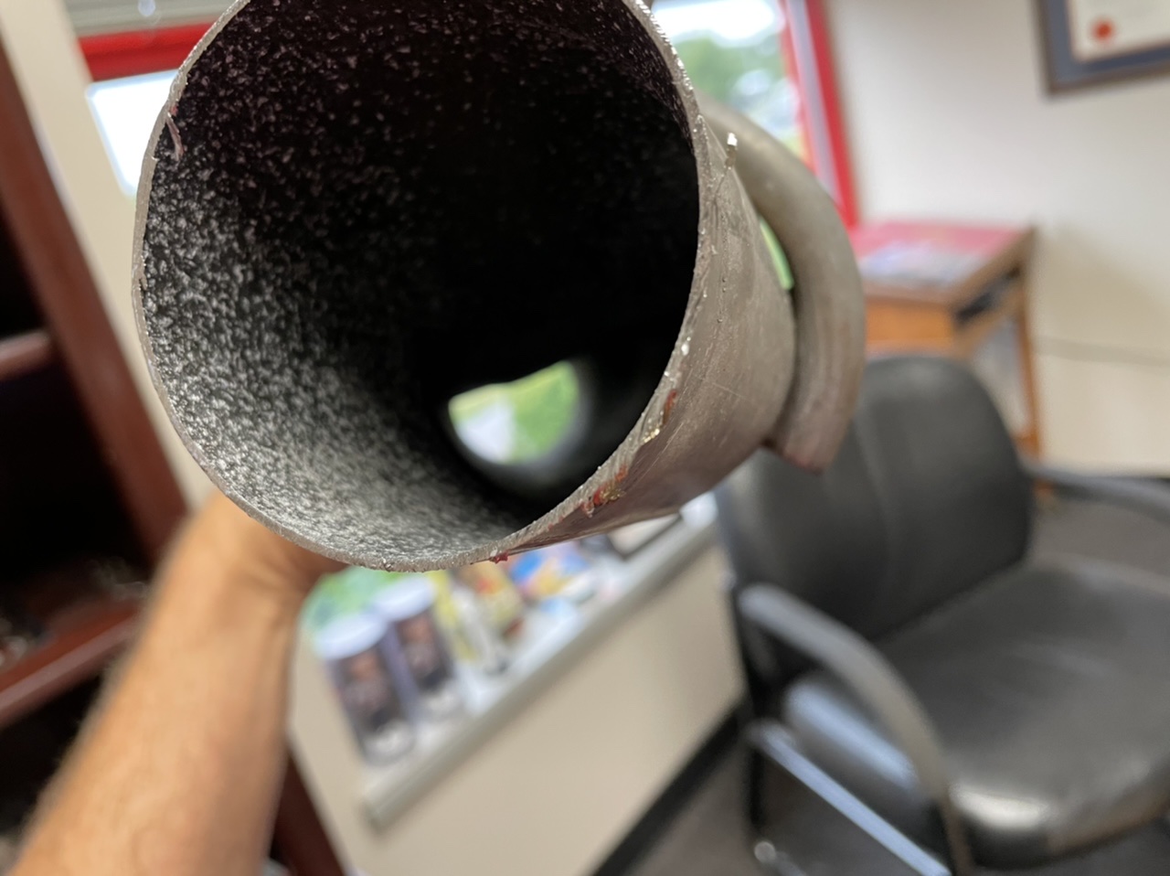

I just put on the Hooker Blackheart Crush Delete pipes. Sound is about the same in “Touring” mode and light throttle but a bit more raucous when I switch to “Sport” and nail it. Perfect! I know that this topic has been beat to death but I couldn’t find any direct posts. Seems like even if the car has enough flow capacity to accommodate the stock engine through the crushed sections, if you add a few mods that seek to move more air through the engine the story might become different. With these in place at least the crush areas are no longer the first, and most obvious, point of restriction in the stock exhaust. I like the stock NPP otherwise. Here are a few photos to show what came out of the car along with the first page of the kit instructions. They make another SKU for the automatic cars.

hope those werent too much $$$ cause they literally do nothing

Yep, wasted your money.

i would call this a vanity upgrade.

Not sure how this qualifies as a vanity upgrade since they’re not seen at all. Just a bit more noise on the open valve and the aerospace engineer in me appreciates the potential for extra flow should I go for more serious flowrates in this 6.2 liter pump. Otherwise, my dough, my go. Thanks guys.

OP, as you already stated, your money, your call It certainly looks better and if it gives you peace of mind, that's all that matters.
You might want to remove the word "performance" from the thread title, though, this does absolutely nothing for performance.

OP does bring up an interesting question: we know the crushed parts don't hurt the performance on a bone stock LT1, but what about when modded?
I am assuming the ZL1 also has crushed pipes and those also don't hurt the performance, but I am guessing here.

Regarding the flow, no it does not make more power per se by replacing the crimped section but it ABSOLUTELY affects the sound quality. There was a write up about the SS I read (will have to dig for it) and the GM engineer noted that there was no negative impact to performance for the crushed section since its actually ovoid in shape almost with similar flow capability. However, the sound quality was "impacted" certainly with the crushed area per the engineer.

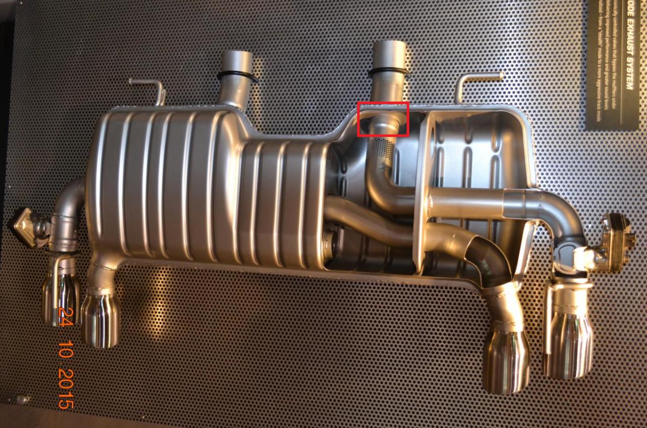

The muffler itself has inlets that neck down to 2.1" on each side when you look inside the inlets after the pipe (have to cut to see it), despite the inlet pipes being larger going to the muffler itself. I know this because I cut the muffler off of mine when I made muffler deletes using the OEM tips. I measured it with a caliper on each side and it was TINY. Mine is a ZL1 but it would be the same on yours. The muffler flows decently well anyways as its straight through when the flapper is open, but you're still limited by the pipe diameter and the flapper mechanism sitting in the exhaust pipes that has to engage rapidly when you hit a certain throttle position and obviously takes up a bit of space.
Exhaust gas flow has cooled a lot by the time it hits the muffler so I dont think on a SS it will make a ton of power, but I absolutely noticed a very nice gain in responsiveness and "pep" as well as sound quality when I removed the crushed area on mine and the suitcase and ran 3" pipes with resonators out the back. Might be less noticeable on a SS but I wouldnt be surprised if you felt a bit of a boost with the crushed pipes and muffler gone. The computer targets a set torque value so without a tune you may not see or keep real gains, but again you will notice the throttle response I promise.
There was a post around here somewhere from a reputable tuner in the ZL1 forums noting that cars with a true 2.75" + swapped axle-back on modified cars consistently showed the highest dyno numbers assuming all parts being equal, vs the OEM suitcase equipped cars. Not sure where the post was, and I doubt gains were huge at all, but 2.1" is pretty damn small for a V8 even if its at the end of the exhaust so it would make sense. See the red box area in the pic attached.
