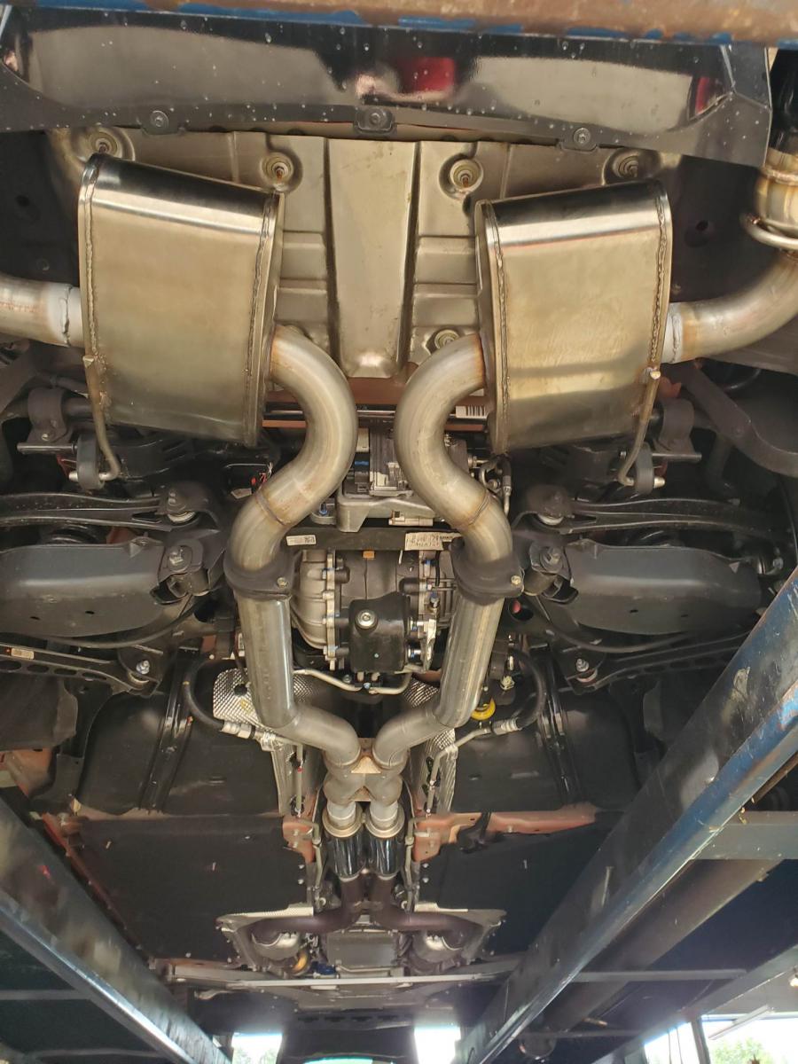

Just got the finishing touches for the catback exhaust all done. Stock manifolds/cats, dual 28" Magnaflow resonators before the OEM X-crossover, 3" crimp delete with flanges and a Corsa 2.75" Sport Axleback with black tips.
Absolutely no drone, smooth tone, no rasp. You can hear the X-pipe clearly (the crossflow noise at the down rev portion). Loving it!

So no NPP funtionality.

Nope. No need or desire for it. Zero drone, all the flow, all day sound.

The NPP isn't really needed until you install headers. Some would say its still not then but it doesn't get really LOUD until you install headers.

Cold start video added. I'm in love. Stoked to hear it with the 2" longtubes. I have room for two more resonators if needed and the car will have UHO Green Cats (850hp per bank) so it should be louder but not brutal.
There is ZERO drone with the current setup. Super refined sounding. Hats off to Corsa for building side branch resonators inside of a muffler. I had the same setup on my 370Z but the side branches were off of the rear muffler delete not inside the muffler, less sleek but it worked wonders.
