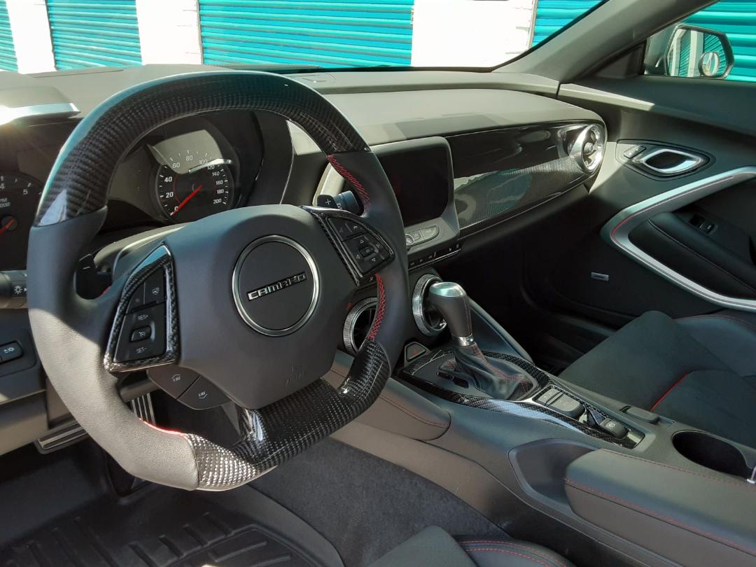

Wildhammer has the custom carbon fiber steering wheels. I got mine in leather, as I do not like suede.

Thanks, Thats exactly the wheel I would like. Was it difficult to install?

Normally, it is just airbag removal, a wiring connector or two, and 1 bolt. However....the factory installed bolt would not come out, so I took it to my dealer, who installed the new wheel for $100.
It must have been a real problem, because he called me and said he hoped I didn't want the old wheel back.
Glad I didn't watch.

oh boy that's scary. maybe I'll just get it installed by someone. Love the way yours looks. Is that the dark red stich or regular red.

I'm not sure. Probably bright red.
Most people have had no difficulty installing them. My bolt just did not move, even with an electric impact gun.

The one bolt that holds the steering wheel in place is a giant T50 torx with blue threadlocker liberally applied, so it's infamously difficult to remove without stripping. No idea why GM couldn't use a normal hex bolt or maybe three.
Removing the airbag is no biggie, I did that when I replaced the paddle switches with their red Corvette counterparts, but I'd let someone else unbolt the steering wheel (and not mess up the clock spring either ).

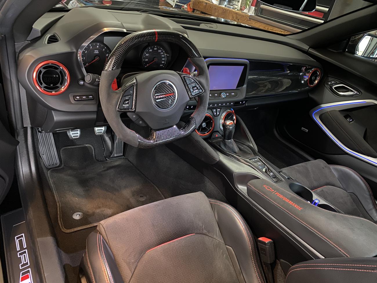

Your best bet is to find someone with compressed air tools if you don’t want the dealer to remove the steering wheel. My friend and I were able to remove the T50 Torx bolt with his compressed air ratchet.
My ZL1 is a m6. I got the shift knob and steering wheel from Wildhammer Motorsports.
I love the Alcantara steering wheel. Also have it in my C8 Corvette. You’ll find the downside to the carbon fiber and leather is a hot to the touch steering when your car sits in the heat of summer. Don’t have that problem with the Alcantara.

This is one badass interior, congrats You are missing only one thing: https://americancarcraft.com/product...-choose-finish

Thanks for the compliment. I agree the look of the dead peddle is pretty dead.
I take my ZL1 to lots of car shows and cruise-in. I’m going to guesstimate with a 99.8% certainty that most people don’t even notice the dead peddle except me. As a result, it hasn’t been a high priority to improve its looks.
