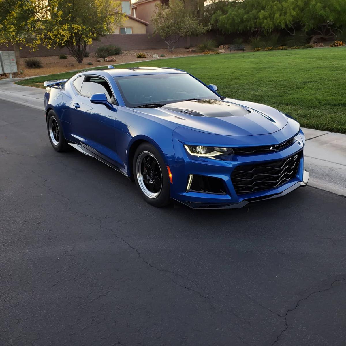

Zl1 new personal best 1/4 mile!
Last night this car outperformed my expectations. I ran 10.21 @ 135.88 with a 1.4 60'. This was my 2nd run ever on the slicks. Da was around 3600 here in vegas. Maybe I'm optimistic but I believe i can see 9s on this setup. I recently added a forgestar dragpack with MT street R's. This is bolt on car with the following.
Rotor fab
Ported stock tb
Kong ported blower
2.3 upper pulley
Headers
3" exhaust to corsa mufflers
E50
Meth injection
Tcm tune.
305/45/17 rears
28x6 fronts
I spent the money to make hp but was always disappointed at track times. The drag pack solved that and made it all worth it!
Work performed by Joe at cordes performance. He has been amazing to work with and I highly suggest to anyone.

Yep, 9s are possible with that trap speed.

simple setup with amazing results! Good job and congratulations!

Great job! Nice 60 ft! With that DA I think 9's are very attainable!!!

Wow I’m impressed. Very nice and congratulations. Seems like a very simple setup.
