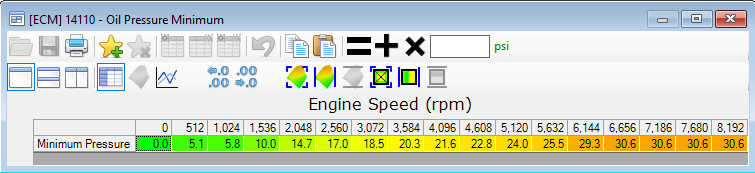

If the pressure (psi) goes below these levels it will set the oil pressure light
this is awesome because according to GM the minimum oil pressure at 1000 RPM is 22 psi.
the oil light comes on at 25% of that...

I actually have not tested this table, just was digging around in HPT, I "assume" it is correct. It is from a LT4 ZL1.
