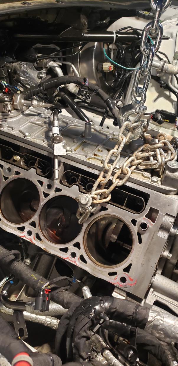

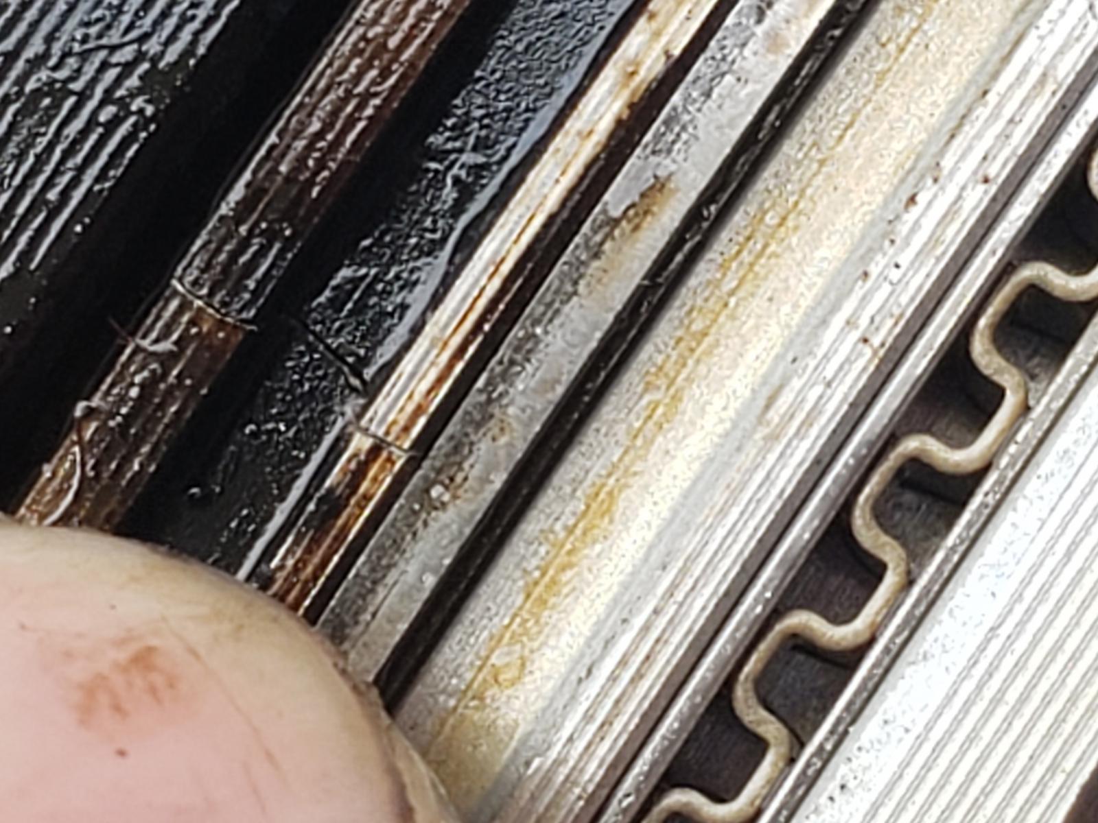

So I began the tare down and go ahead and do forged anyway. Found number 2 with a very very slight crack almost did not see it and was trying to figure how it was at 22% I even began thinking maybe it was bad rings but they looked fine no signs of deto plug looked perfect. Looking very close in good light I saw what I though was a crack going from the top ring land to the second. called the wife better eyes to look at it. she caught her finger nail on it a couple times and it popped out when she hung it. It was still slightly attached.
Next why? 7 pistons still great but one bad. everyone says ring butt, i checked the ring gap very thoroughly. Using dial caliper to make sure ring is even from the top showed 14 thou. I do not believe this is a ring butt problem. Even thats on the tight side. Also if a ring butts hard enough to break a piston then I would think their would be some bore scar. bore is perfect no problems.
I put a ring in a motor one time that was for a 10 over bore filed it down to have correct end gap and it still scared the cylinder where the ends met. was a 2 stroke motor.
So not a ring gap problem. no signs of deto or pre ing. plug looks perfect, rod Bering perfect, That only leaves me to one conclusion. defective pistons or they just can't handle the power level. it was 660 wheel. But some pistons can. Its just a luck of the draw. Some pistons are good and some are not as good. That's my thinking. Coupe I had before this with 9 pds had about 20000 miles no problem.

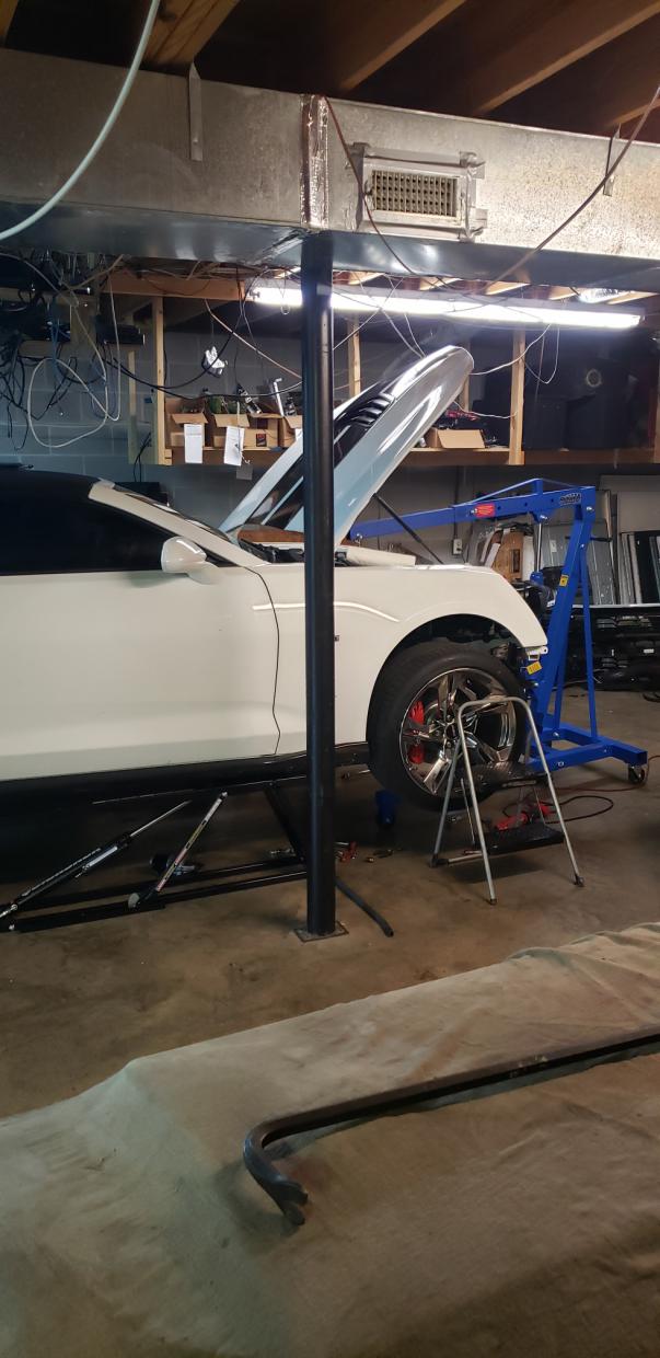

Doing rods and pistons in the car ? I would not do it any other way. I did not touch the cradle steering ect. just dropped the aluminum brace that unbolts lifted the motor to bell housing touching the car and the pan came right out I have a quick jack and an engine hoist. its not bad at all. I have pulled a motor and this is way way easier. Now if you are doing a cam at the same time I dont know about that. I will be upgrading the oil pump while I'm their. I might do a pound or 2 more boost, then the p1sc will be maxed. 660 is a fun car on the street and thats where it will be. Looking to do drop in rods and pistons.

Wow man, and just over a year boosted. I'm sorry for your loss and hope you get a hold of some forged rods and pistons soon. I see you are in Tennessee, did you get it tuned at high altitude? Maybe the tune was on the ragged edge and you lean spiked down here at sea level? I know you said you didn't see any clear signs of detonation, but it probably wouldn't take much to harm the factory pistons at the power level you were at. Impressive for a p1sc, good numbers.
Guessing you were on 93 octane + meth, I personally wouldn't go over 9 lbs on a factory engine without some E85.

You are like #35 with meth kit boost and broken LT1 just on this forum alone never mind all the others.
We run these engines at 750 RWHP and they don't break when they have both enough fuel and quality fuel.
Relying on a meth system for fuel supply is the number 1 engine killer on DI engines.
You must have adequate fuel systems, Low side, high side, & injectors, then put all your fuel in with the injectors and you will have a happy engine.
Your right it is not the ring gaps.
