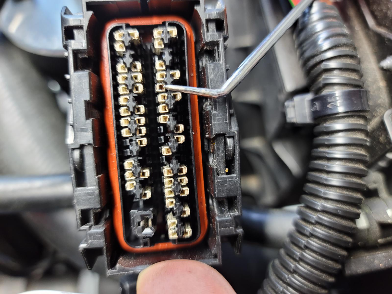

Hello guys so I have a little issue going on and I can't seem to figure it out. I installed a DSX flex fuel sensor and I have got a remote tune and I'm getting code P0178 has nobody git this before?
I have made sure pin 38 is in correctly and took it apart 2 times to double check. And yes I removed the blue cover to make sure pin is even with the rest.

Picture of pin installed on 38

You’re definitely in #38. Where are you getting power for the sensor? Coil?

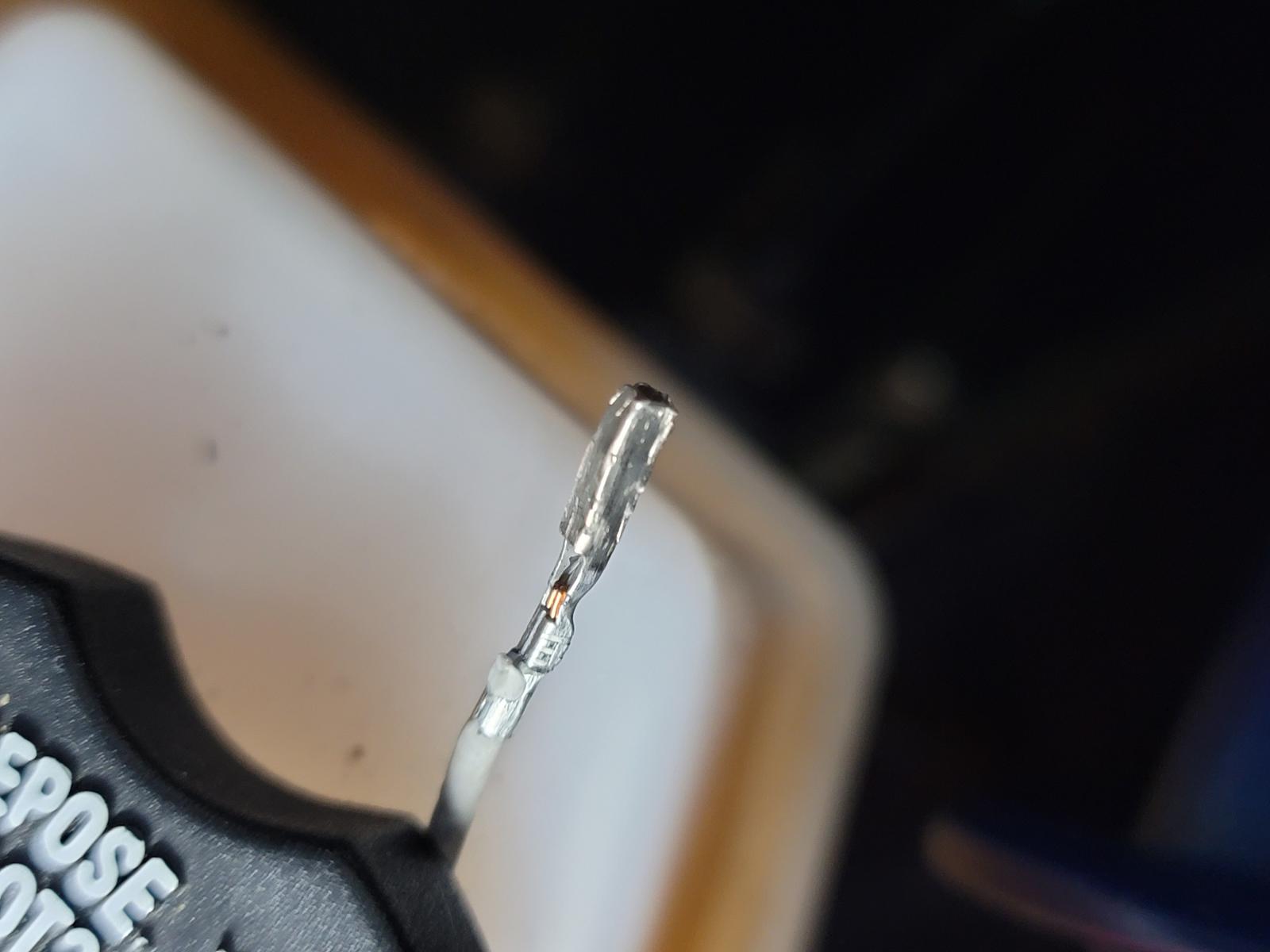

So I figured out a way to test the ECU for 5V from pin 38. The power is there. I pulled pin out for the 20th time and noticed that the pin is a little defective. Might be the issue.

If you have a male pin, do a pin drag test. That should give you an idea if the pin is damaged or weak. Maybe the pin is actually pushing back into the connector. I’ve seen this many times over the years. I’ve at times wither replaced the pin or if I’ve been under pressure to get the machine going I will bend the retaining tab to get the pin to seat in the connector.
Check the connector too to make sure the retaining tooth isn’t broken or missing or damaged. If it is then you will need to order a new pin housing.
