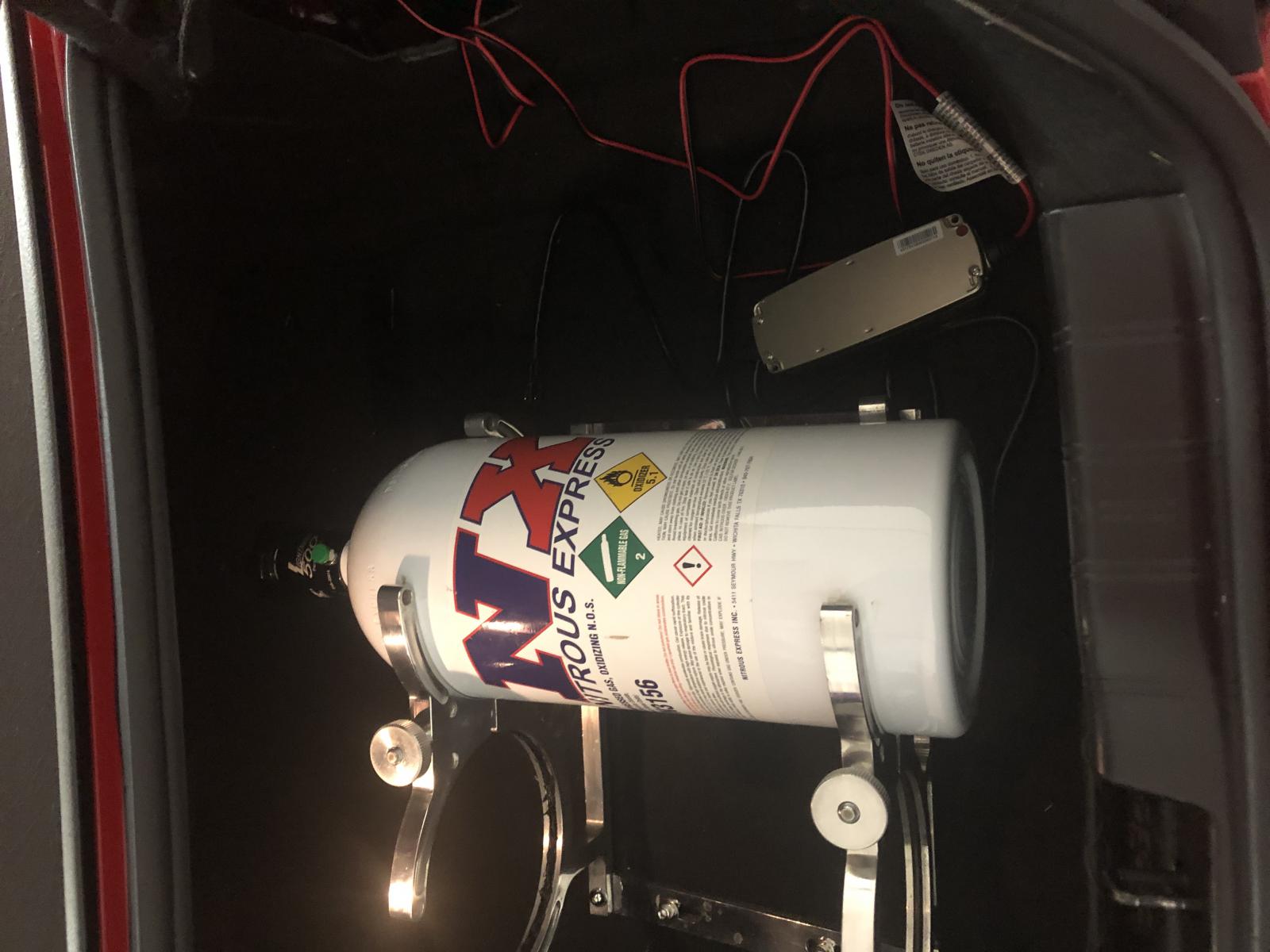

Currently finishing up a nitrous install on my 1le. Is there anyone that has found a good way to mount the bottle in the trunk without having to drill into the car? Thinking about mounting to a piece of painted wood and velcroing to the trunk liner but someone may have a better method. Also had to route everything through the sound tube plug and use a grommet instead.

I cut a piece of aluminum the same size as the cardboard type material and drilled my holes in it
