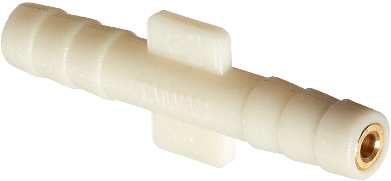

Ah.... looked closer at your pics... youve got the same covers as me.. I bet its EXACTLY same problem as me bud.
Get a small 1/8' restrictor like this, put it inside smaller vaccuum tube so it stays snug, then put that piece inside the clean side.
Camaro1973 is offline   Reply With Quote

That i dont, but any parts store should have a 1/8 vaccuum restrictor. Honestly its just a 1/8 - 1/8 adapter, all you want to achieve is to lower the high vaccum that's coming out of thats flowing through that 5/8" hose. The can is under full vaccuum.
You want to really only pull 1-3" vaccumm through the can.
