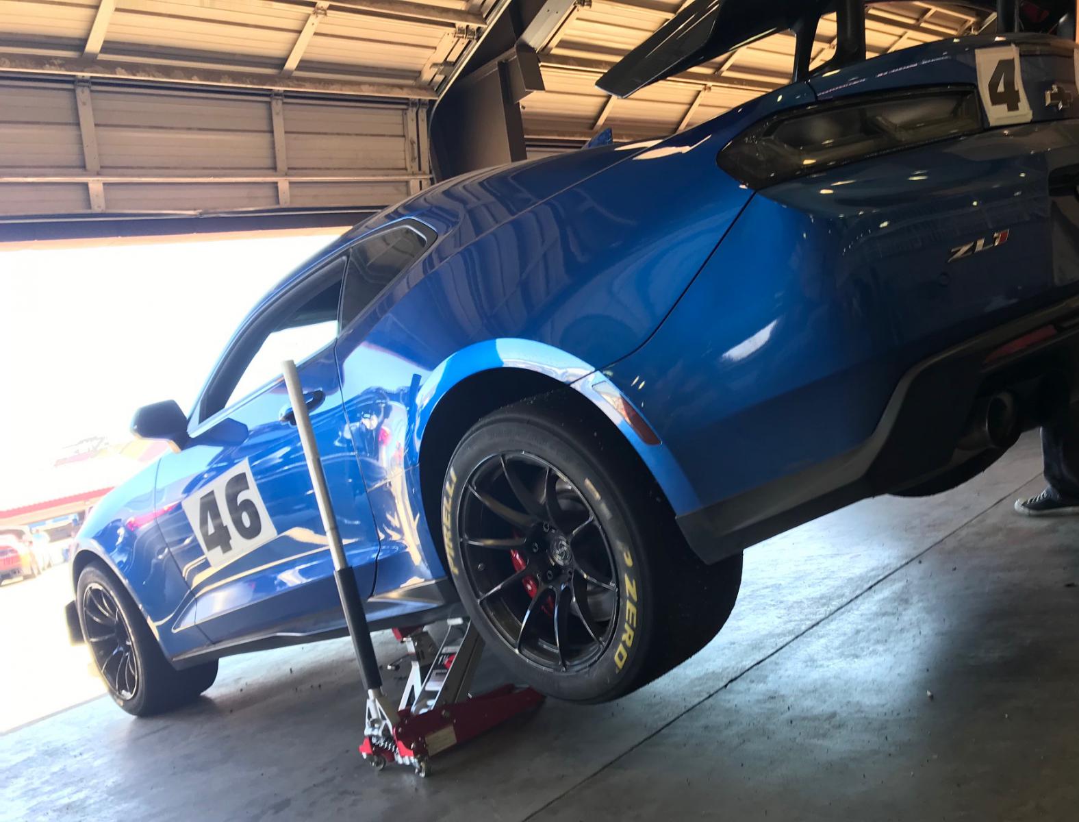

Posts: 1,365
You need to wait until your tires get warm, not necessarily the road, although a combo of both is best.
10-15 minutes of spirited driving in the LA canyons behind my house usually does the trick even on a cold day or night, and lately I'm running Pirelli DH take-off slicks as my street tire (I never drive my ZLE in water). PS4S will take less time to heat up, and once they do they should hook up well at stock HP.
What rims are those? They look great. Would love to run the take offs vs the price of the sc3r's, are you stock power? And how well do they hold grip once warmed up?
Thanks, these are Signature SV501s in 18x11 front/18x12 rear. I am running stock power, I need my warranty and as a track car this thing doesn't need more power it needs a better driver.
The Pirelli DH take-offs in that pic were great, they were as fast or faster than new SC3Rs and I set a personal best that day at Auto Club Speedway.
That looks awesome with big meaty slicks on those rims.
