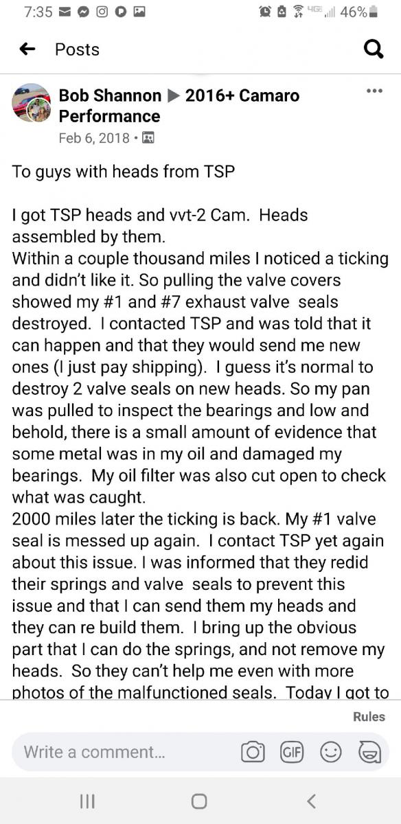

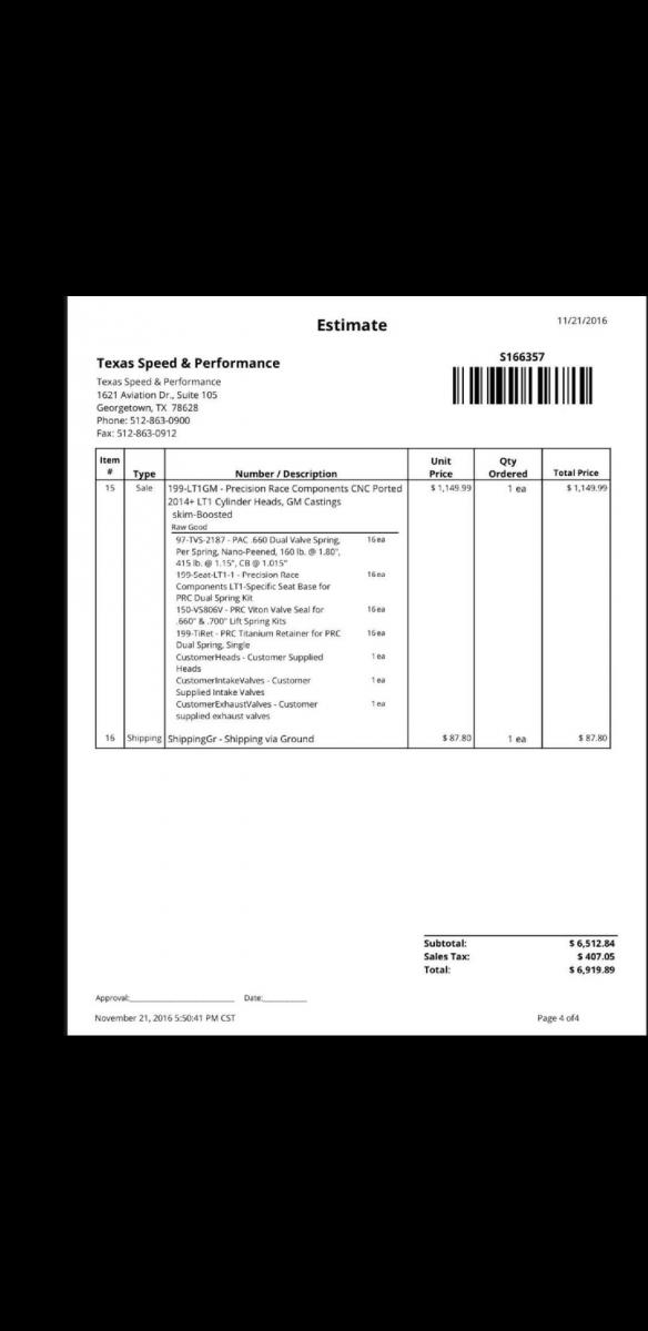

I found a interesting post on TSP valve springs and valve seals that they were having issues with in late 2016 and earlier 2017 that they now have changed. These heads were done in Nov of 2016 by them. Below I will post the screen shot of the post and if you look at the part #'s that he posted and look at the build sheet of mine from 2016 the part numbers match.
