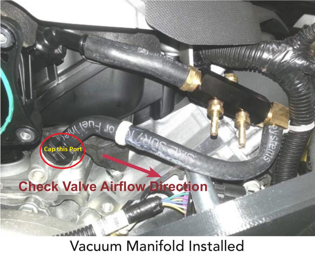

I routed it this way: Thanks to Dysan911.
Yeah so using the photo as an example. Cap the lower valley port off and then connect the upper hose like it's shown in the photo. Instead of it going into the valley port It will connect to the one side of the MMS Catch can that has the built in PCV (checkvalve) on it. The other side of the can will connect to the adapter that replaces your Oil cap.
Intake--->ProchargerHexManifold---->MMSCatchCan_PCV--->ValveCoverOilCap_Adapter.
