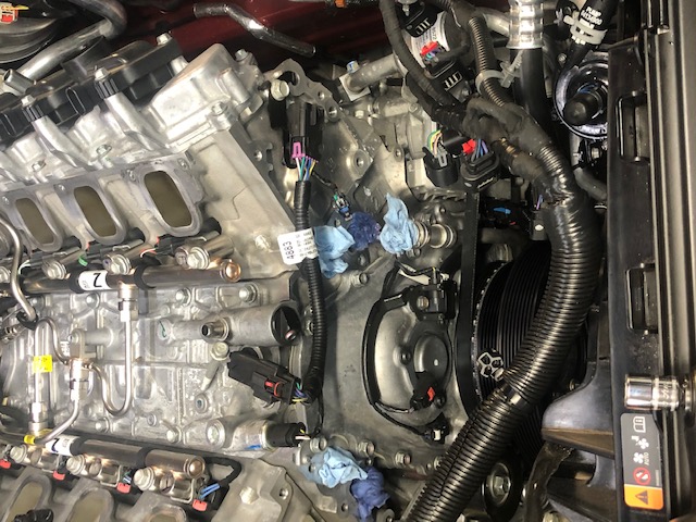

Hey guys I'm going to attempt to document my winter build. I am by no means computer savvy so I will try my best. It's a 18 ZL1 M6 I bought last year with 900 miles on it. Over the past year I did a KONG ported blower, NW 103 TB, RotoFab big gulp, ATI w/ 9.1 lower, Kooks 2" headers, Borla resonated mid section and S type exhaust, MM catch can and Cordes 1 gallon reservoir tank. The car made 719 rwhp on a Dynocom and it was an absolute blast to drive. Move forward a year and I am wanting more. New mods include:
MTI cam kit (custom specs 22x/24x 6xx/6xx 112icl w/ 116lsa), BTR V2 trunnion s, C5r timing chain, New GM oil pump, FED ported heads, Cordes performance 2.5 gallon bumper tank, Cordes Aux fuel system w/ flex and a 2.3 upper pulley.
Some tear down pics
07 LMB Z06 Cartek 4x heads and cam, ARH, Vararam, FAST 102, NW 102
18 ZL1 M6 MTI cam, FED heads, FBO's
