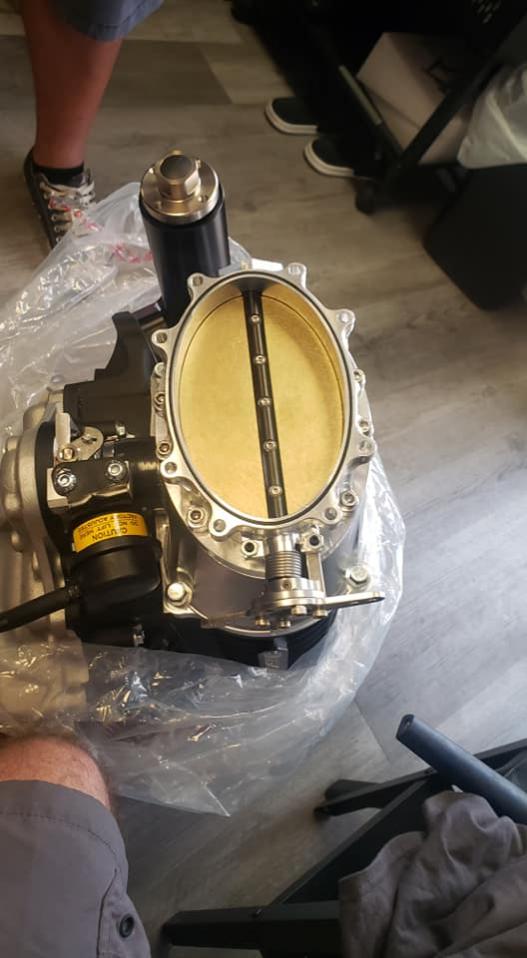

Here you go, bigger is better right? Let's go for 123mm.
This one is fine if you want the option of "ON" or "OFF" throttle wise
