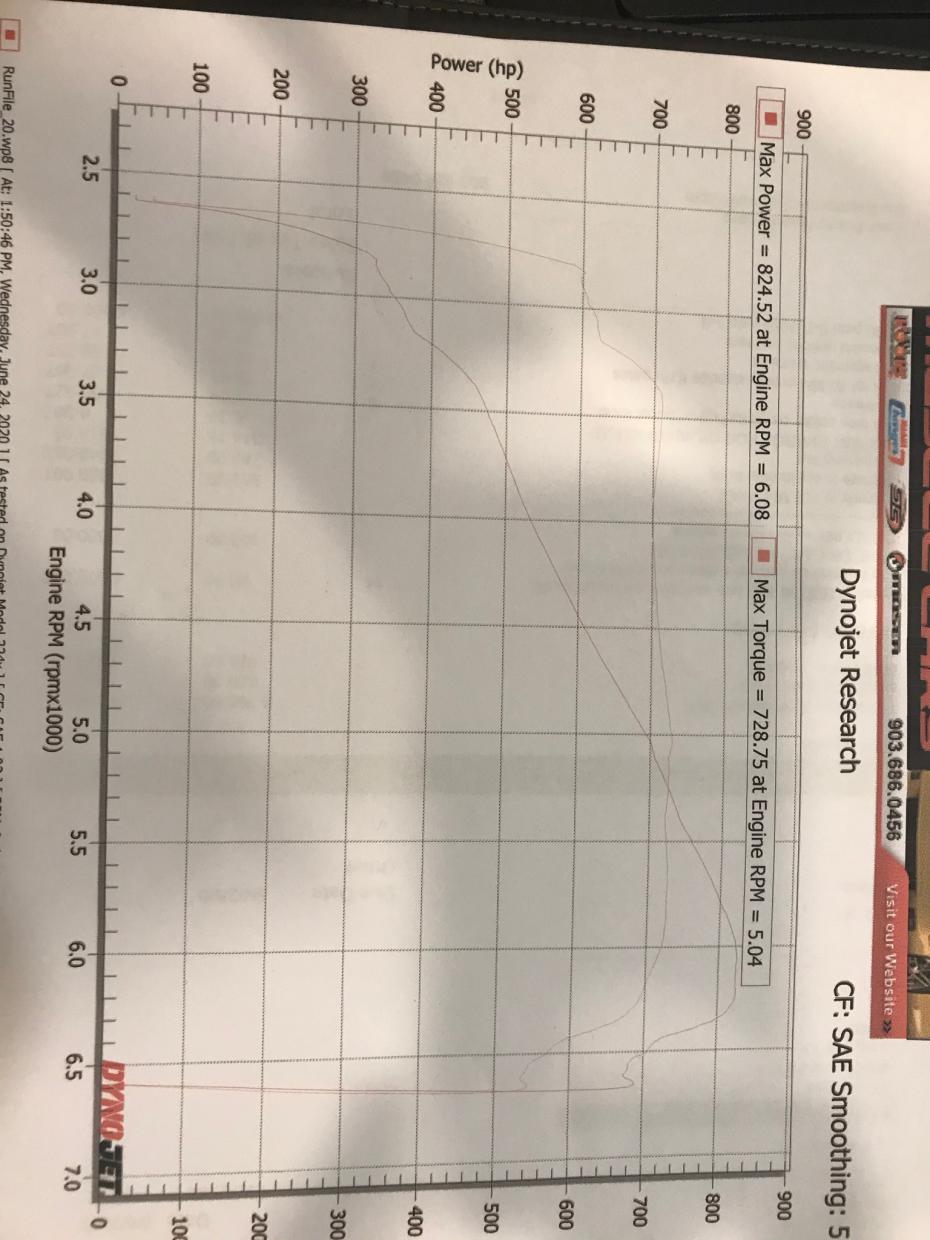

I’m hitting 824 Rwhp with a 2650, headers, lower pulley, Rotofab on 93
Impossible. The stock fuel system is only good for 700whp.
You need to be running a Cam/Meth to hit that horsepower.
Sorry I left out that I am running a cam
Flexhorn is offline   Reply With Quote

824 Rwhp on stock fuel
I like that torque curve. I am not interested in running a cam yet, maybe much further down the line. I wanted to know what I could get away with no fuel mods, and then only low side mods. I wish their was a guide that says the approximate limit with each mod and combinations of them but that would be a lot of R&D.
Without a cam or meth, your looking about 700 rwhp max, doesnt really matter what bolt ons you use. The boost a pumps don't really do much either. If your just on the border of say 700-710 it may help you get there, but that's really it.
