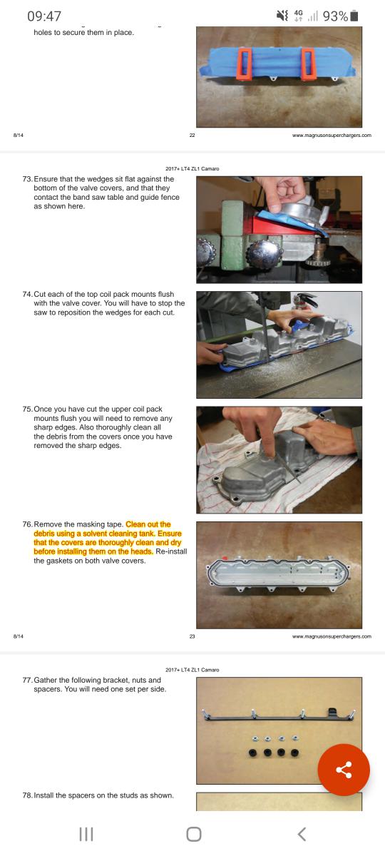

May I ask a naive question? What kind of modification is needed on the stock valve covers to fit the Magnuson 2650 on the ZL1?

You only have to cut off the upper coil pack mounts.
I also wanted to get the Speed Engineering covers at first, but then I read about all the problems with oil beeing sucked out. Even with catch cans!

The mods' to the valve covers are easy. It took me just as long to remove and reinstall as the cutting. It would go faster if you have a band saw probably, but I used a sawzall, and cleaned the cuts up with a Dremel, and it was totally fine. I'd just make sure to tape-off all the openings and keep everything clean so you don't drop crap into the top of the engine. It was a little scary, but it was fine after the first cut was done, HAHAHA. If you can change your oil, you can probably do this.
