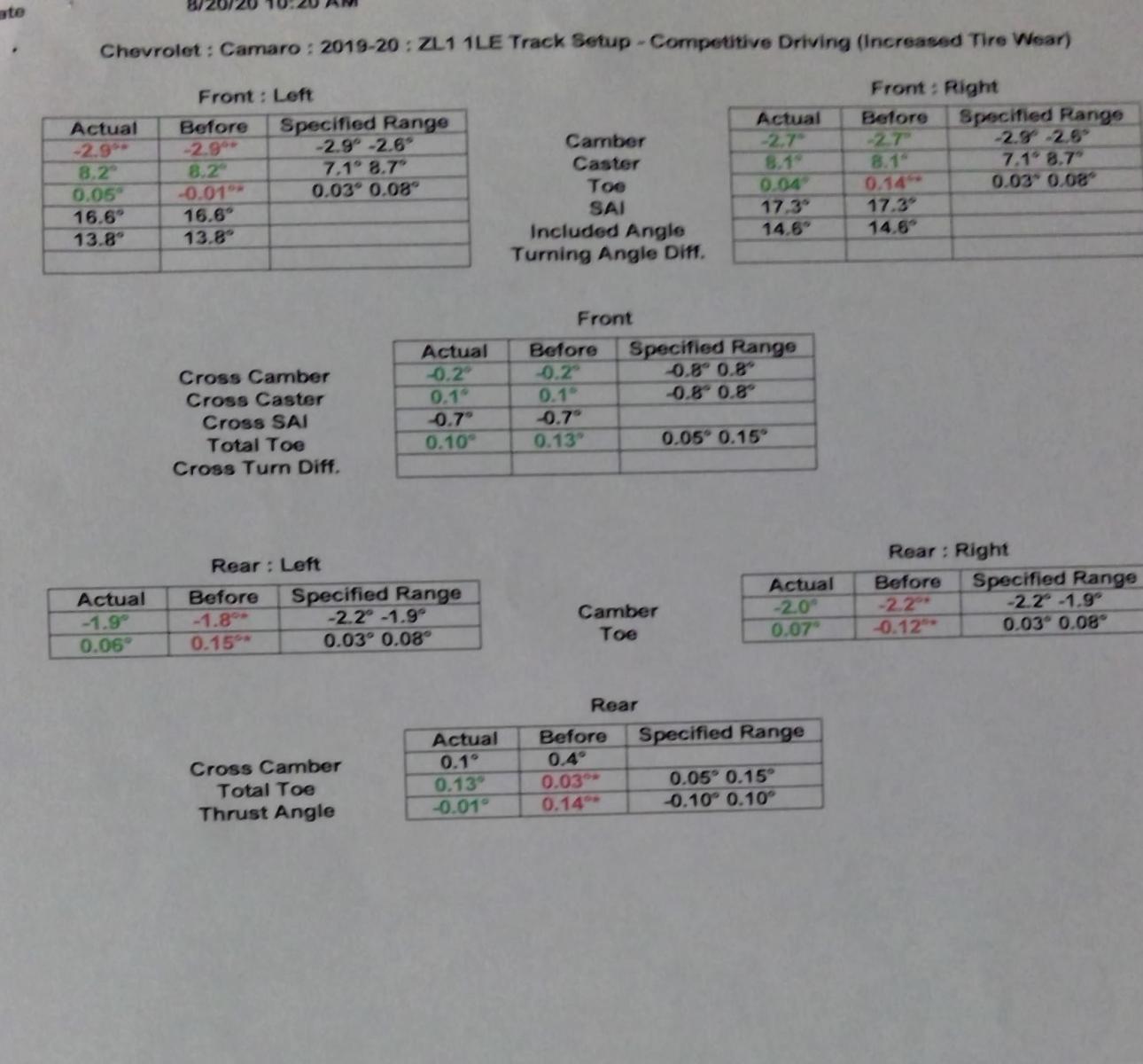

Also, they re-did the alignment But the steering wheel is still off by 2 degrees to the right. I'm confused and trying to find out why my steering wheel is still crooked. Current alignment spec is attached as well. Has anyone with ZLE track spec alignment had steering wheel angle being off issue? If so, how did you guys got it corrected.

Wheel is easily adjusted some by tie rod end threads, after alignment is done. They try to center as much as possible during alignment, especially if done with customer in car holding wheel and there to have proper weight in car. Then they can just adjust tie rod ends for precise final setting of wheel.

Front toe adjustments are very sensitive. After I set total toe, I generally ride around on a flat road (highway), run PDR and get an exact reading on steering wheel. For my car, 2* is less than 90* of each front toe rod to straighten the wheel. Make sure you look at thread direction to avoid changing total toe. You want to move the wheels in same direction steering wheel is off. The caster will center it up front.
Also, a 90* adj on one rod is equal to just under 1/32” total toe for me. 180* (or 90* each side is about 1/16” total toe.
Note: none of this applies to rear wheels.

With the alignment, a tire that has some lateral force variation can cause a pull on an otherwise excellent alignment. Swap the fronts side to side and see if the pull changes. Try the rear too if no change. We are assuming the tires are all worn similar to each other and the pressures are the same. Your #s look good, not perfectly symmetrical, but very close, all within the allowed cross tolerances.
As TWG1 mentioned, the adjustments are very sensitive. I once adjusted one front tie rod adjuster on my '14 1LE a half a flat, which is 1/12 of a turn of the adjuster and felt the change in how the car drove.
