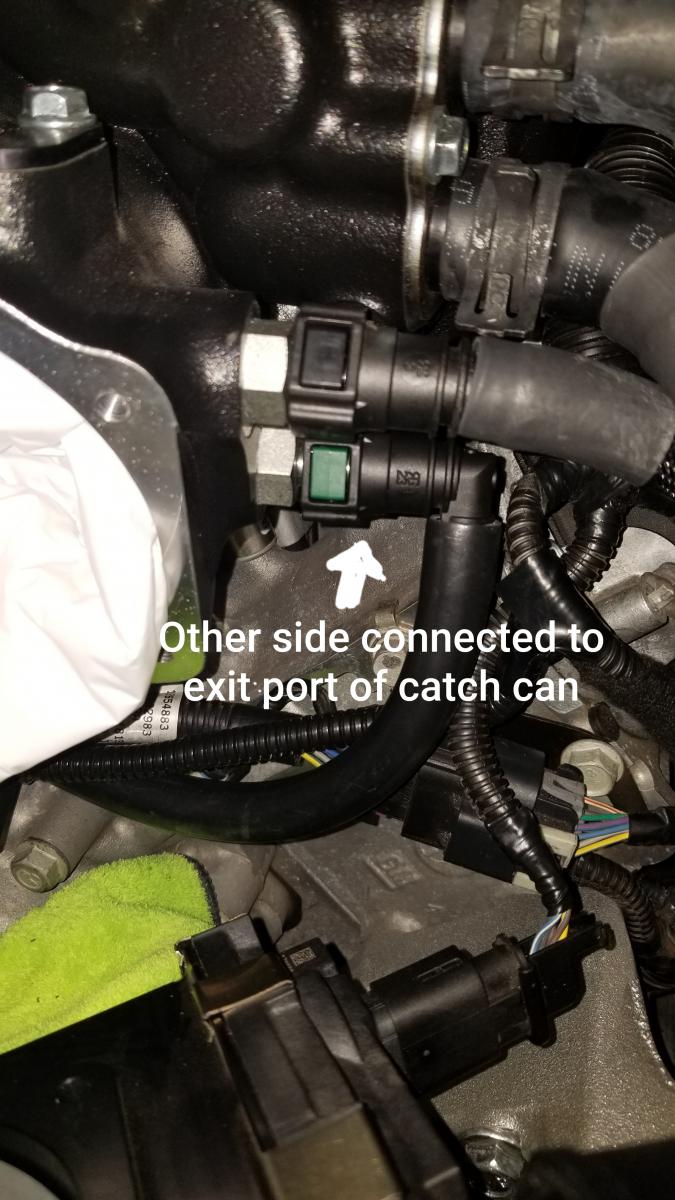

I bought the Mighty Mouse Wild version. I currently have the larger "in" side of the can(above the window) connected to the oil fill cap location, can't really mess that up. The exit side of the can is connected to the lower port on the side of the supercharger snout (in pic). The nipple under the throttle body, where a short hose to the snout used to be, was then capped off. Is this correct?

I'm soon installing a catch can, so interested in the answer here. My understanding is the inlet should be from the PCV hose, rather than the clean side ...??

Looks good to me!

Yeah I found that on Mighty Mouse's site earlier today and buttoned her up. I've been driving around today and everything seems well. Thanks again!
