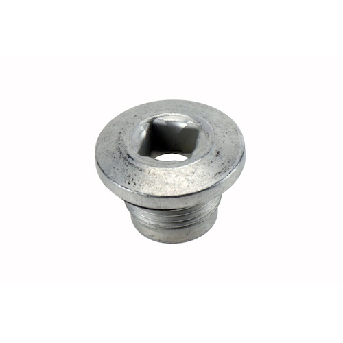

Does anyone know the replacement part for the rubber washer on the rear diff? Mine is so smashed down it was leaking.

I don't know the OEM # and believe you may be buying the plug as well to get it. This is what I've been using:
(10 gaskets now for about $11 bucks)
https://www.dormanproducts.com/p-695-097-139.aspx
https://www.amazon.com/Dorman-097-13.../dp/B001SG7SSC

That's perfect! thanks

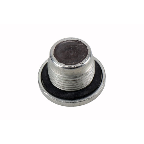

Mine was leaking from the plug, the washer was so crushed down it wasn't sealing. So I just ordered a pack of these and will swap them out each time I flush it. I've just been doing mine once a year.

Just on the Diff plugs. The first Diff drain/flush I reused the OEM ones as is. Since I've done 7-8 more Diff fluid changes because I track my car. I believe I change them each time, or at least put the better of the two up at the fill, and replace the lower drain plug gasket.

It's an old thread, but I want to make sure that the Dorman gasket, 097-139, perfectly fits in our differential drain plug(GM Part # 55573646)?
