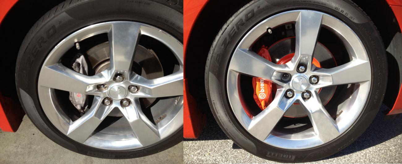

i did my 2011 calipers, used orange engine enamel from advance, added hi temp brembo decals from amazon, then clear coated with hi temp enamel. looked great years later when i traded it in (nov '19). You will need to pull the calipers to paint, I recommend paining the disk center hub and edge as well.
Ive already bought the decals for the 2019 but the originals are still new, lol.

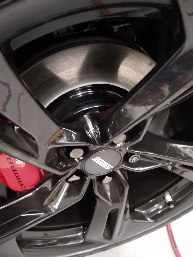

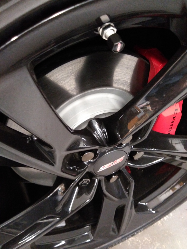

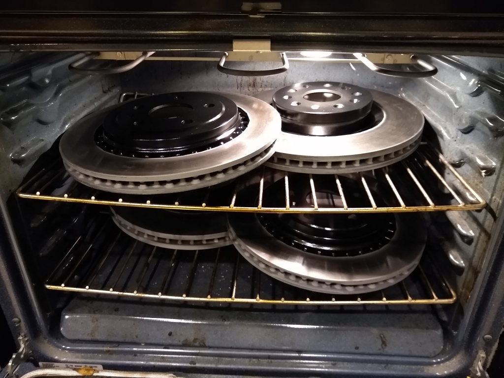

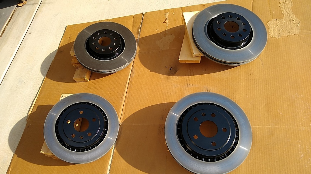

I painted my rotor hubs with VHT Caliper Paint, I hated the Battleship Gray they were painted and wanted them black like my wheels..
Worked great!
This part was the wife's idea!!! (How many wife's would say "Put your rotors in the oven!?!?!?!?!")
